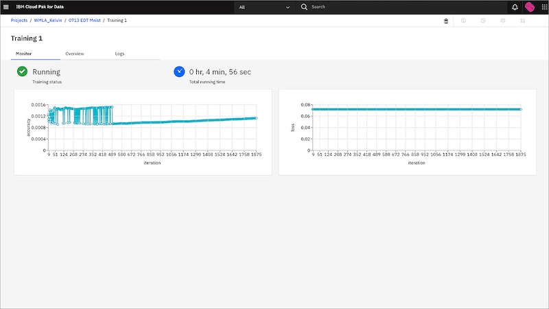

Figure 2. Running a training simulation on Watson Studio. Image used courtesy of IBM
If satisfactory results do not occur, various changes to the structure and parameters of the network can be made. The neural network training is carried out with the help of algorithms; the most common training algorithm is called Stochastic Gradient Descent. The success of training can be measured in various ways relating to error. For example, one method often used with deep learning neural networks is the loss function, which must be lower at the end of the training process.
