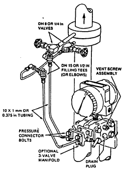

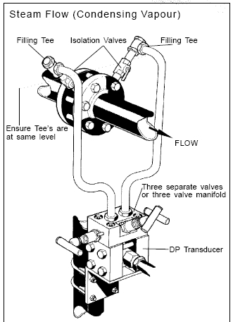

The idea is to
- have two condensate pots, one for each impulse leg, at exactly the same elevation
- have a constant level of water in each leg, so that at all flows, the head pressure of the liquid column in the impulse tubes will be equal, and therefore will contribute any pressure to either side of the DP.
Read Sam's post above, and look at a couple of these graphic illustrations to get an idea of what the seal pots should be doing.

This one shows the Filling Tees that do the same thing as a condensate pot, that Sam is talking about, on a horizontal steam pipe:
http://i41.tinypic.com/b97zon.jpg

This one shows close coupled filling Tees above the horizontal steam pipe
http://i42.tinypic.com/206jwp1.jpg
