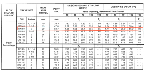

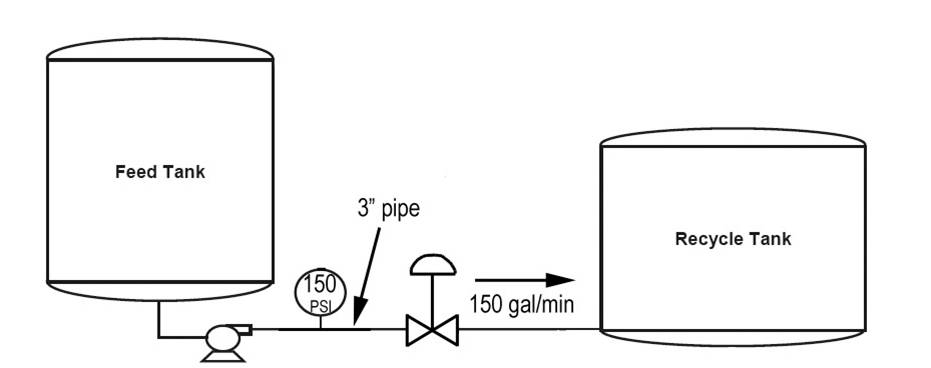

You will find here after some precious informations on the subject that you posted here:
Valve Sizing and Selection
What is Cv?
The definition of Cv factor is the number of G.P.M. that will pass through a valve with a
pressure drop of one (1) psi. A unit of measure for comparing valve flows.
STEP #1: Define the system
The system is pumping water from one tank to another through a piping system with a total
pressure drop of 150 psi. The fluid is water at 70 0F. Design (maximum) flowrate of 150 gpm, operating flowrate of 110 gpm, and a minimum flowrate of 25 gpm. The pipe diameter is 3 inches. At 70 0F, water has a specific gravity of 1.0.
STEP #2: Define a maximum allowable pressure drop for the valve
When defining the allowable pressure drop across the valve, you should first investigate the pump. Remember that the system pressure drop is limited by the pump.
The usual rule of thumb is that a valve should be designed to use 10-15% of the total pressure drop or 10 psi, whichever is greater. For our system, 10% of the total pressure drop is 15 psi which is what we'll use as our allowable pressure drop when the valve is wide open (the pump in our system is easily capable of the
additional pressure drop).
STEP #3: Calculate the valve characteristic
STEP #4: Preliminary valve selection
Don't make the mistake of trying to match a valve with your calculated Cv value. The Cv value should be used as a guide in the valve selection, not a hard and fast rule. Some other considerations are:
a. Never use a valve that is less than half the pipe size
b. Avoid using the lower 10% and upper 20% of the valve stroke. The valve is much easier to control in the 10-80% stroke range.
Before a valve can be selected, you have to decide what type of valve will be used. For our case, we'll assume we're using an equal percentage globe valve. The valve chart for this type of valve is shown below.
For our case, it appears the 2 inch valve will work well for our Cv value at about 80-85% of the stroke range. Notice that we're not trying to squeeze our Cv into the 1 1/2 valve which would need to be at 100% stroke to handle our
maximum flow. If this valve were used, two consequences would be experienced: the pressure drop would be a little higher than 15 psi at our design (max) flow and the valve would be difficult to control at maximum flow. Also, there would be no room for error with this valve, but the valve we've chosen will allow for flow surges beyond the 150 gpm.
STEP #5: Check the Cv and stroke percentage at the minimum flow
If the stroke percentage falls below 10% at our minimum flow, a smaller valve may have to be used in some cases. Judgement plays role in
many cases. For example, is your system more likely to operate closer to the maximum
flowrates more often than the minimum flowrates? Or is it more likely to operate near
the minimum flowrate for extended periods of time. It's difficult to find the perfect valve, but you should find one rates well most of the time.
Referring back to our valve chart, we see that a Cv of 6.5 would correspond to a stroke
percentage of around 35-40% which is certainly acceptable.
