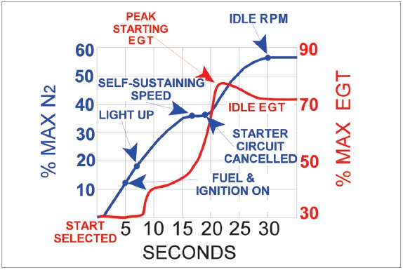

Why the gas turbine exhaust gas temperature gets higher value in startup then its back to normal?
There are two significant EGT rises in a jet engine start up before it stabilises with other engine parameters.
The engine start up begins when the pilot selects the engine mode selector to the start position. When this happens, the bleed air either from the onboard APU or from a ground starter unit runs an air starter motor which is mechanically geared to the high pressure compressor, N2. As the N2 rotates, you wait until a certain motoring speed is reached. This will depend on the type of the engine. Once N2 reaches this speed, fuel is introduced by the pilot using the fuel switches or the engine master switch, which sends fuel into the combustion chamber through the fuel nozzles. When the fuel is on, the first parameter that rises is the EGT. This increase in EGT is sharp. Why this happens is because, there is excess fuel in the chamber compared to air which leads to a hot burn. But as soon as this excess fuel is burnt off, the EGT rise rate reduces.
Then comes the final EGT peak. This occurs due to the acceleration of the compressor stages of the engine. Because of the increased acceleration, more fuel is introduced into combustion chamber which rises the EGT a second time. But because the compressor keeps on accelerating, the air to fuel ratio reaches a mean value for engine to operate at idle. At this point, the EGT reaches a peak and slowly stabilise at idle value.
The peak EGT the engine reaches is an important value because constant high start up values can deteriorate the health of the engine. When I used to operate Dash 8s we checked this peak value at every start up. If the APU is weak or the ground power unit is not up to the mark, the EGT or the ITT temperature can reach very high values, sometimes even turning on the ITT over temperature light. Some of our Dash 8s had such weak APUs that we start the aircraft with both the APU and ground power unit connected to the aircraft electrical system, to reduce the peak temperature. Dash 8 of course did not use air to start the engines, but the APU, GPU or the batteries power the aircraft onside DC generator which acts as a starter generator for the start up.
