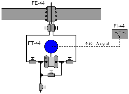

A pneumatic DP transmitter measures the flow of gasoline through a an orifice plate, using a separate square root extractor relay to characterize the signal so that it may be displayed linearly on the receiver gauge (FI-20):
Based on other flow-measuring devices in this process, operations personnel have determined the actual flow rate through this pipe is 158 gallons per minute. FI-20, however, registers a flow of 142 gallons per minute. Based on the data you see in this illustration, determine the location of the calibration error.
The error lies either with the DP transmitter (FT-20), unequal fluid inside the impulse tubes, or with the orifice plate itself (FE-20). One quick check would be to drain the impulse tubes (allowing fresh process gasoline to fill the tubes) and seeing whether that fixes the problem. It’s a quick procedure and it would eliminate that problem from the realm of possibility.
Another way to diagnose the problem is to remove FT-20 from service and test its calibration with applied pressures to its “H” side port. If FT-20 checks out okay, the problem must be with the impulse tubes or the orifice plate.

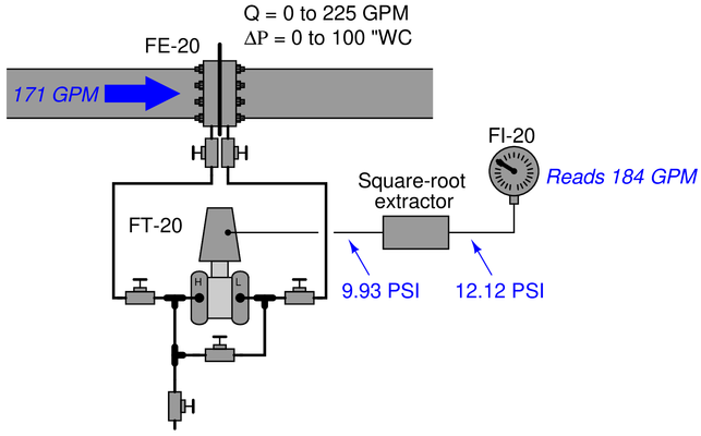

Based on other flow-measuring devices in this process, operations personnel have determined the actual flow rate through this pipe is 171 gallons per minute. FI-20, however, registers a flow of 184 gallons per minute. Based on the data you see in this illustration, determine the location of the calibration error.
The error lies with the indicator (FI-20).

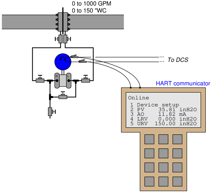

A “smart” DP transmitter with built-in square root characterization is used to measure flow through a pipe. The orifice plate range is 0 to 150 inches WC at 0 to 480 gallons per minute:
Operations personnel have strong reason to believe that the actual flow rate through this pipe is 160 GPM, yet the DCS registers a flow rate of 182.4 GPM. Based on this information, determine the likely source of calibration error in this system. Also determine whether this transmitter has square-root characterization enabled or not.
Additionally, suggest a good “next step” to perform to either pinpoint the location of this problem or correct it.
The calibration error lies either with the transmitter, the impulse lines (unequal fluid heights inside), or with the orifice plate itself. The transmitter does have square-root characterization enabled.
A good “next step” would be to block and equalize the transmitter manifold to check what its PV and AO parameters register with no applied differential pressure.
