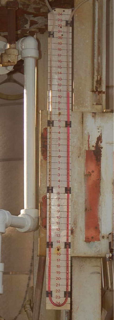

Interpret the pressure measurement displayed by this U-tube manometer, recalling that the pressure will be equal to the difference in heights between the two liquid columns:
The pressure difference is approximately 22 inches of liquid column.

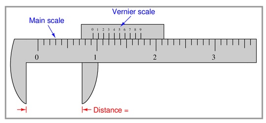

Machinists use a tool called calipers to measure short distances such as the outside diameter of a shaft. One particular type of caliper has a special scale that slides along with the movable jaw called a vernier scale. The spacing between divisions on the vernier scale is slightly less than the spacing between divisions on the main scale, which means only one division on the vernier scale will ever line up with a division on the main scale at any given time:
In order to obtain a coarse measurement of the caliper’s jow position, read the main scale using the “0” mark on the vernier scale as a pointer:
Now, use the vernier scale to read the distance between the caliper’s jaws, when the “0” division on the vernier scale does not line up perfectly with one of the divisions on the main scale:
Distance = 0.93
Interpret the distance between the jaws of this vernier caliper:
2.14 units
