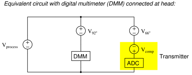

Part of this solar-heating control system uses a dual-thermocouple circuit to compare the temperature inside the solar collector against the temperature inside the house, preventing the circulation fan from running if the house is ever warmer than the collector:
Answer the following questions about this subsystem:
{\bullet} Identify the thermocouple type used in this application, and determine whether or not this type is a good choice.
{\bullet} Calculate the voltage measured at the input terminals of the transmitter, and also determine whether or not this transmitter needs to be enabled for reference junction compensation.
{\bullet} Identify the meaning of the diamond-shaped PID symbol labeled “TC”.
These are type ‘T’ thermocouples, sending 1.174 mV to the transmitter’s input. Cold junction compensation (CJC) should not be enabled in the transmitter, because we want to measure the difference in temperature between the collector and the house, not compensate for one of those thermocouples’ voltages!
The diamond symbol is a logic device—most likely a PLC—used for on/off control of the fan.
Calculate the voltage sensed by the analog-to-digital converter inside the temperature transmitter:
Voltage at ADC: $35.948~mV$

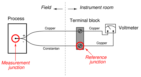

Suppose you walk up to this thermocouple, installed to measure the temperature of an enclosed process vessel, and connect a sensitive voltmeter to the terminals at the junction head:
Determine the process temperature if you read 7.825 mV with the voltmeter connected to the screw terminals inside the thermocouple head. Assume a head temperature of 92 °F.
Suppose at some later time you connected the voltmeter to the transmitter’s input terminals and read 8.332 mV. Calculate the process temperature at this time, assuming an ambient temperature of 66 °F at the transmitter.
An equivalent circuit diagram shows the relationships between the thermocouple measurement junction (in the process), the two reference junctions formed where thermocouple wire meets copper wire, the digital multimeter, and the temperature transmitter (when the DMM is connected at the head):
$T_{process} = 388~^{\circ}F$ at 7.825 mV (measured at 92 °F head)
Another equivalent circuit diagram shows the relationships between the thermocouple measurement junction (in the process), the two reference junctions formed where thermocouple wire meets copper wire, the digital multimeter, and the temperature transmitter (when the DMM is connected at the transmitter):
$T_{process} = 385~^{\circ}F$ at 8.332 mV (measured at 66 °F transmitter terminals)

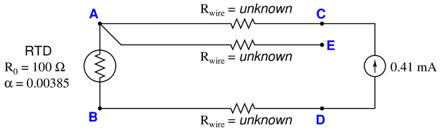

Calculate the voltage across the bridge ($V_{AB}$) at the following RTD temperatures, assuming a 604 $\Omega$ nickel-iron RTD with an alpha value of 0.00518:
{\bullet} $T = 0~^{\circ}C$ ; $V_{AB}$ =
{\bullet} $T = 81~^{\circ}C$ ; $V_{AB}$ =
{\bullet} $T = -45~^{\circ}C$ ; $V_{AB}$ =
{\bullet} $T = 320~^{\circ}F$ ; $V_{AB}$ =
All answers shown here based on tabulated values for the RTD’s resistance (rather than values calculated by formula):
{\bullet} $T = 0~^{\circ}C$ ; $V_{AB} = -0.6989~mV$
{\bullet} $T = 81~^{\circ}C$ ; $V_{AB} = 0.9568~mV$
{\bullet} $T = -45~^{\circ}C$ ; $V_{AB} = -1.6215~mV$
{\bullet} $T = 320~^{\circ}F$ ; $V_{AB} = 2.4831~mV$

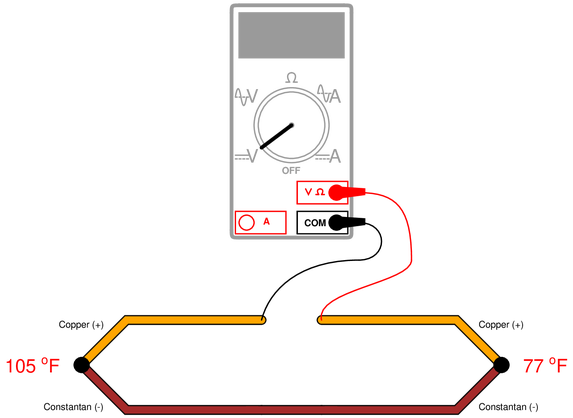

Suppose someone builds a dual-junction thermocouple circuit using type T thermocouple wire (copper and constantan metals), then measures voltage in the loop using a voltmeter:
Calculate the voltage read by the voltmeter, using a type T thermocouple table to find millivolt potentials for each of the junctions.
The voltmeter should read $-3.908$ mV. Counting all the junction voltages (with polarities shown in reference to whether they match or oppose the meter’s test lead polarity):
{\bullet} 193 °F junction = $-3.789~mV$
{\bullet} 71 °F junction = $+0.857~mV$
{\bullet} 102 °F junction = $-1.565~mV$
{\bullet} 59 °F junction = $+0.589~mV$
{\bullet} Loop total voltage = $-3.908~mV$
Hint: any junction pushing conventional flow in a counter-clockwise direction is regarded here as a “positive” figure. Any junction pushing in a clockwise direction is regarded as a “negative” figure.
The last junction (at 59 °F) may be treated as a single copper-constantan junction because the metal type of the meter’s test leads acts as an intermediate metal. The fact that both the copper and constantan test lead junctions are at the same temperature allows us to disregard the test lead metal altogether and treat it as a single copper-constantan junction at 59 °F.
