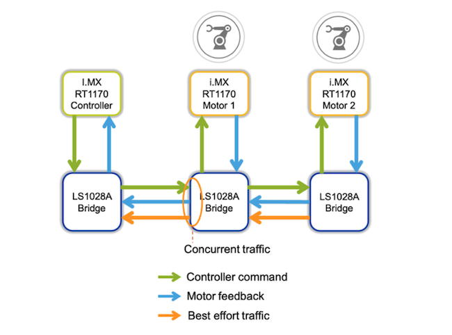

Figure 1. The TSN-capable LS1028A bridge can combine real-time OT motor control and feedback data (blue and green arrows) and best-effort IT traffic (orange arrows) on the same physical Ethernet network. Image used courtesy of NXP
In this article, we’ll investigate the peculiarities of information technology (IT) and operational technology (OT) traffic (Figure 1) and their often competing requirements and how new time-sensitive networking (TSN) standards help alleviate problems that often pose a demanding task for industrial network engineers.

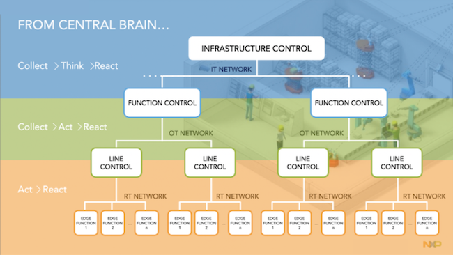

Besides the cost factor, sensor-to-cloud communication imposes another level of complexity to overcome. It requires the network to transmit frames from the very bottom of the hierarchy (the individual sensors) to the top layers (the cloud). This can be seen in Figure 2.
Figure 2. The traditional industrial networking hierarchy looks like a pyramid, and transmitting frames from sensors to the cloud is complex. Image used courtesy of NXP
However, the aforementioned mix of technologies makes this move toward flatter hierarchies in real-time industrial networking practically unviable, as each of the often incompatible protocols needs a bridge to exchange data with equipment using other protocols. Adding such gateways increases the overall network complexity, required maintenance effort, and cost and also leads to potential loss of real-time information and decreased precision.
Finally, engineers want to merge OT and IT traffic on a single network in a deterministic, reliable, secure, and robust way (see Figure 1 again). Industry 4.0 aims to solve all these problems and challenges by introducing a single, unified IP paradigm that allows lower edge sensors and actuators to move data to upper control hierarchies even through the cloud while leaving enough bandwidth for best-effort IT traffic.

Furthermore, TSN aims to create a unifying hardware implementation (Figure 3) that enables tasks such as multi-stream management with hard real-time capabilities, data aggregation, and transmission of larger frames.
The various TSN standards aim to create flatter network topologies that enable edge-to-edge connections in real-time and transmit best-effort traffic over a single line. In summary TSN solves the problems discussed earlier—the problems of enabling sensor-to-cloud frame transmissions without losing intrinsic real-time values.
Figure 3. TSN enables engineers to craft a unifying hardware implementation for performing tasks such as multi-stream management with hard real-time capabilities. Image used courtesy of NXP

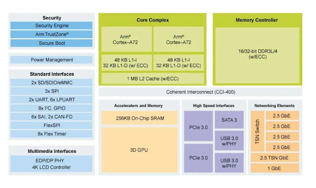

Various devices ranging from low-cost, efficient crossover MCUs (for example, the i.MX RT1170) to more powerful devices—such as the i.MX 8M Plus applications processor—already support TSN. The Layerscape LS1028A is one device specifically designed for use in environments requiring TSN support and support for standard industrial real-time networking protocols, such as IEEE 1588, EtherCAT, Profinet, CAN open, and OPC UA.
By natively supporting the most common protocols, the NXP LS1028A (Figure 4) bridges the gap between proprietary, incompatible networking standards and allows engineers to achieve seamless and secure interoperability across existing manufacturing systems.
Figure 4. Layerscape LS1028A block diagram. Image used courtesy of NXP
Furthermore, the LS1028A can act as a bridge between various TSN and non-TSN industrial protocols, thereby allowing engineers to connect an EtherCAT-enabled system. For example, to other equipment that utilizes another protocol, such as Profinet.
The LS1028A also includes:
  • TSN-enabled Ethernet controllers for TSN endpoint applications
  • Dual 64-bit Arm Cortex-A72 processors
  • ECC support in the L1 and L2 cache and RAM
  • A dedicated 3D GPU
  • An LCD controller
  • State-of-the-art security features ensure the confidentiality and integrity of processed data
