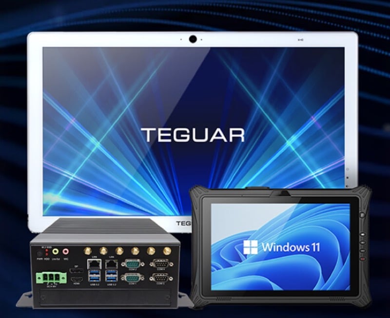

At Automate 2026, industrial and medical PC solutions specialist Teguar will showcase its latest Regiment Series of rugged, fanless, embedded AI PCs. Each subsequent OC technology in the series scales in I/O and computing capacity, as well as form factor, to offer a range from compact edge gateways to high-performance, graphics-heavy industrial applications. Teguar will hold interactive demonstrations featuring PCs from the Regiment Series, including an LLM robotic arm demo with Regis TB-7393 and a FANUC arm.
Teguar invites attendees of Automate 2026 to learn more about the capabilities of its Regiment Series of edge box PCs.
Teguar invites attendees of Automate 2026 to learn more about the capabilities of its Regiment Series of edge box PCs. Image used courtesy of Teguar
