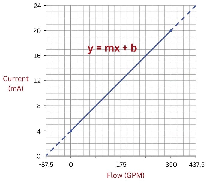

Example Calculation: Flow Transmitter
A flow transmitter ranges from 0 to 350 gallons per minute, 4-20 mA output, and it is direct-responding. Calculate the current signal value at a flow rate of 204 GPM.
One way we could solve for the amount of signal current is to convert the flow value of 204 GPM into a ratio of the flowmeter’s full-flow value, then apply the same formula we used in the previous example relating percentage to milliamps. Converting the flow rate into a “per unit” ratio is a matter of simple division, since the flow measurement range is zero-based:
\[{204 \hbox{ GPM} \over 350 \hbox{ GPM}} = 0.583 \hbox{ per unit}\]
Converting a “per unit” ratio into percent merely requires multiplication by 100, since “percent” literally means “per 100”:
\[0.583 \hbox{ per unit} \times 100\% = 58.3\%\]
Next, we plug this percentage value into the formula:
\[y = \left({16 \over 100}\right)58.3 + 4\]
\[y = 9.33 + 4\]
\[y = 13.33\]
Therefore, the transmitter should output a PV signal of 13.3 mA at a flow rate of 204 GPM.
An alternative approach is to set up a linear equation specifically for this flowmeter given its measurement range (0 to 350 GPM) and output signal range (4 to 20 mA). We will begin this process by sketching a simple graph relating flow rate to current:
The slope (\(m\)) for this equation is rise over run, in this case 16 milliamps of rise for 350 GPM of run:
\[y = \left({{20 - 4} \over {350 - 0}}\right)x + b = \left({16 \over 350}\right)x + b\]
The y-intercept for this equation is 4, since the current output will be 4 milliamps at zero flow:
\[y = \left({16 \over 350}\right)x + 4\]
Now that the linear equation is set up for this particular flowmeter, we may plug in the 204 GPM value for \(x\) and solve for current:
\[y = \left({16 \over 350}\right)204 + 4\]
\[y = 9.33 + 4\]
\[y = 13.33\]
Just as before, we arrive at a current of 13.33 milliamps representing a flow rate of 204 GPM.

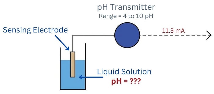

Example Calculation: pH Transmitter
A pH transmitter has a calibrated range of 4 pH to 10 pH, with a 4-20 mA output signal. Calculate the pH sensed by the transmitter if its output signal is 11.3 mA.
First, we will set up a linear equation describing this temperature transmitter’s function:
Note how we are free to set up 4-20 mA as the independent variable (\(x\) axis) and the pH as the dependent variable (\(y\) axis). We could arrange current on the \(y\) axis and the process measurement on the \(x\) axis as before, but this would force us to manipulate the linear equation to solve for \(x\).
Calculating and substituting the slope (\(m\)) value for this equation, using the full rise-over-run of the linear function:
\[y = \left({{10 - 4} \over {20 - 4}}\right)x + b = \left({6 \over 16}\right)x + b\]
Solving for the y-intercept value using the coordinate values of 4 pH and 4 mA, we see again that this is an application where \(b\) \(\neq\) 4 mA. This is due to the fact that the instrument’s input range (i.e. the domain of the \(y = mx + b\) function) does not begin at zero:
\[4 = \left({6 \over 16}\right)4 + b\]
\[4 = 1.5 + b\]
\[b = 2.5\]
Therefore, our customized linear equation for this pH transmitter is as follows:
\[y = \left({6 \over 16}\right)x + 2.5\]
Calculating the corresponding pH value for an output current signal of 11.3 mA now becomes a very simple matter:
\[y = \left({6 \over 16}\right)11.3 + 2.5\]
\[y = 4.24 + 2.5\]
\[y = 6.74\]
Therefore, the transmitter’s 11.3 mA output signal reflects a measured pH value of 6.74 pH.

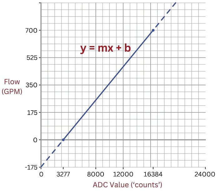

Example Calculation: PLC Analog Input Scaling
An Allen-Bradley SLC500 programmable logic controller (PLC) uses a 16-bit analog-to-digital converter in its model 1746-NI4 analog input card to convert 4-20 mA signals into digital number values ranging from 3277 (at 4 mA) to 16384 (at 20 mA). However, these raw numbers from the PLC’s analog card must be mathematically scaled inside the PLC to represent real-world units of measurement, in this case, 0 to 700 GPM of flow. Formulate a scaling equation to program into the PLC so that 4 mA of current registers as 0 GPM, and 20 mA of current registers as 700 GPM.
We are already given the raw number values from the analog card’s analog-to-digital converter (ADC) circuit for 4 mA and 20 mA: 3277 and 16384, respectively. These values define the domain of our linear graph:
\[y = \left({{700 - 0} \over {16384 - 3277}}\right)x + b = \left({700 \over 13107}\right)x + b\]
Solving for the y-intercept value using the coordinate values of 0 GPM and 3277 ADC counts:
\[0 = \left({700 \over 13107}\right)3277 + b\]
\[0 = 175 + b\]
\[b = -175\]
Therefore, our PLC scaling equation for this particular flowmeter is as follows:
\[y = \left({700 \over 13107}\right)x - 175\]

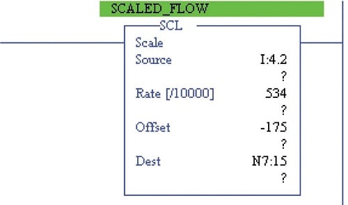

This type of scaling calculation is so common in PLC applications that Allen-Bradley has provided a special SCL (“scale”) instruction just for this purpose. Instead of “slope” (\(m\)) and “intercept” (\(b\)), the instruction prompts the human programmer to enter “rate” and “offset” values, respectively. Furthermore, the rate in Allen-Bradley’s SCL instruction is expressed as the numerator of a fraction where the denominator is fixed at 10000, allowing fractional (less than one) slope values to be specified using integer numbers. Aside from these details, the concept is exactly the same.
Expressing our slope of \(700 \over 13107\) as a fraction with 10000 as the denominator is a simple matter of solving for the numerator using cross-multiplication and division:
\[{700 \over 13107} = { r \over 10000}\]
\[r = 534\]
Thus, the SCL instruction would be configured as follows
