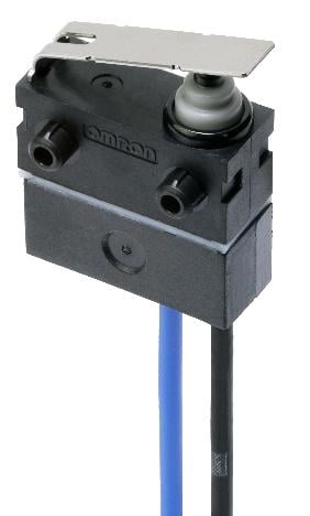

D2AW-R: A Drop-In Upgrade
The D2AW-R series is designed as a direct replacement for existing D2AW microswitches. It shares the same outline and stroke options, so designers can upgrade to four-state detection without changing housings. Two chip resistors are mounted inside, and the maximum power rating per resistor is 0.5 W. The sliding contact mechanism ensures smooth actuation and long life. Multiple terminal options are available including PCB terminals, press-fit terminals and versions with molded lead wires to accommodate various assembly methods. The devices are sealed to IP67 (excluding terminals), making them suitable for harsh environments with water spray or dust.
Applications for the D2AW-R series include security devices such as smart meter covers, safes, anti-theft device covers and automatic locking systems. Because the resistors are inside the switch, tampering attempts like wire cutting or shorting are detected immediately. In factory automation, D2AW-R switches provide failure diagnosis by detecting wire disconnection and switch failures.

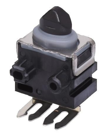

D2EW-R: Ultra-Subminiature and Versatile
For applications where space is at a premium, OMRON offers the D2EW-R series. Measuring just 8.3 × 7.0 × 5.3 mm, the D2EW-R retains four-state detection while supporting multi-angle plunger operation without a lever. The series uses the same sliding contact architecture as the D2EW family and has IP67 sealing and high resistance to vibration and shock. Because the resistors are built in, the system can differentiate between normal switch-open or switch-closed status and an open circuit or short circuit at the terminals. This capability extends diagnostic monitoring in industrial automation and enhances security in vending machines and smart meters.
The D2EW-R’s space-saving design is complemented by flexible mounting options. Polarized mounting posts or M3-screw mounts simplify installation, while press-fit  terminals, solder terminals and molded lead wires provide assembly flexibility. The devices operate from 5 V to 18 V over a temperature range of −40 °C to 85 °C. This makes them suitable for battery-powered devices and low-voltage control circuits. The switches target security applications requiring anti-tamper functionality—smart meters, safety boxes, surveillance cameras and automated locking systems—as well as factory automation equipment such as industrial robots, autonomous mobile robots and AGVs.
