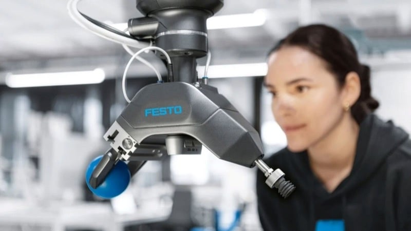

GripperAI allows robots to automatically identify, select, and grip changing products.
GripperAI allows robots to automatically identify, select, and grip changing products. Image used courtesy of Festo

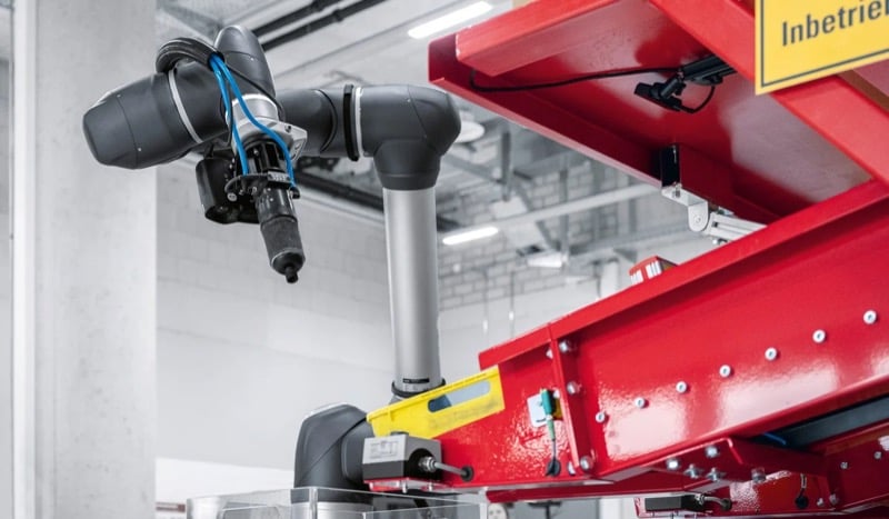

Würth Group has already implemented the technology at its distribution hub in Germany, where product variety and rising SKU counts have created handling challenges. The system uses a tool station containing multiple vacuum and mechanical grippers to handle products ranging from small USB devices to boxes weighing up to 44 lbs. By allowing the robot to determine gripping strategy automatically, the system addresses ergonomic concerns while maintaining throughput in higher-speed packaging operations.
