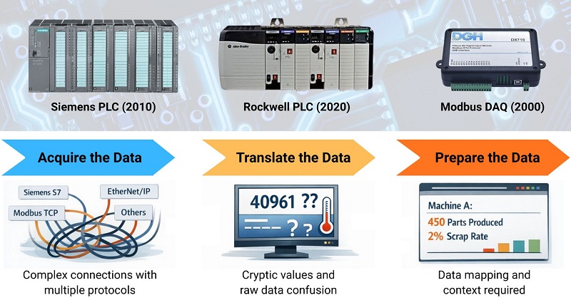

The Problem: Why Is Manufacturing Data So Hard to Use?
Walk onto any factory floor, and you'll probably find equipment from different manufacturers, installed over several decades. A Siemens PLC from 2010 sits next to an Allen-Bradley controller from 2018 and a legacy machine with a Modbus connection from 2005. Each uses different protocols and data formats.
When engineers need to use this production data for a dashboard or quality analysis, they face three major challenges.
Challenge 1: Extracting the Data
Each machine requires specific technical knowledge to connect. You need to understand Siemens S7 protocol, Allen-Bradley Ethernet/IP, Modbus TCP, and dozens more. A single production line might require expertise in 5-10 different protocols.
Challenge 2: Making Sense of the Data
Even after connecting, the raw data is cryptic. A temperature sensor might report "40961" without units or context. Is that 40,961°F? A register value? Without understanding how each device structures its data, these numbers are meaningless.
Challenge 3: Preparing the Data for Analysis
Your business systems—dashboards, analytics platforms, AI tools—expect organized, contextualized information. They do not care that “Register 1045 = 450” or “Register 2031 = 9.” Instead, they need to know “Machine A produced 450 parts with 2% scrap rate.”
 Figure 1. The challenge of manufacturing data is converting from collection to useful analysis.

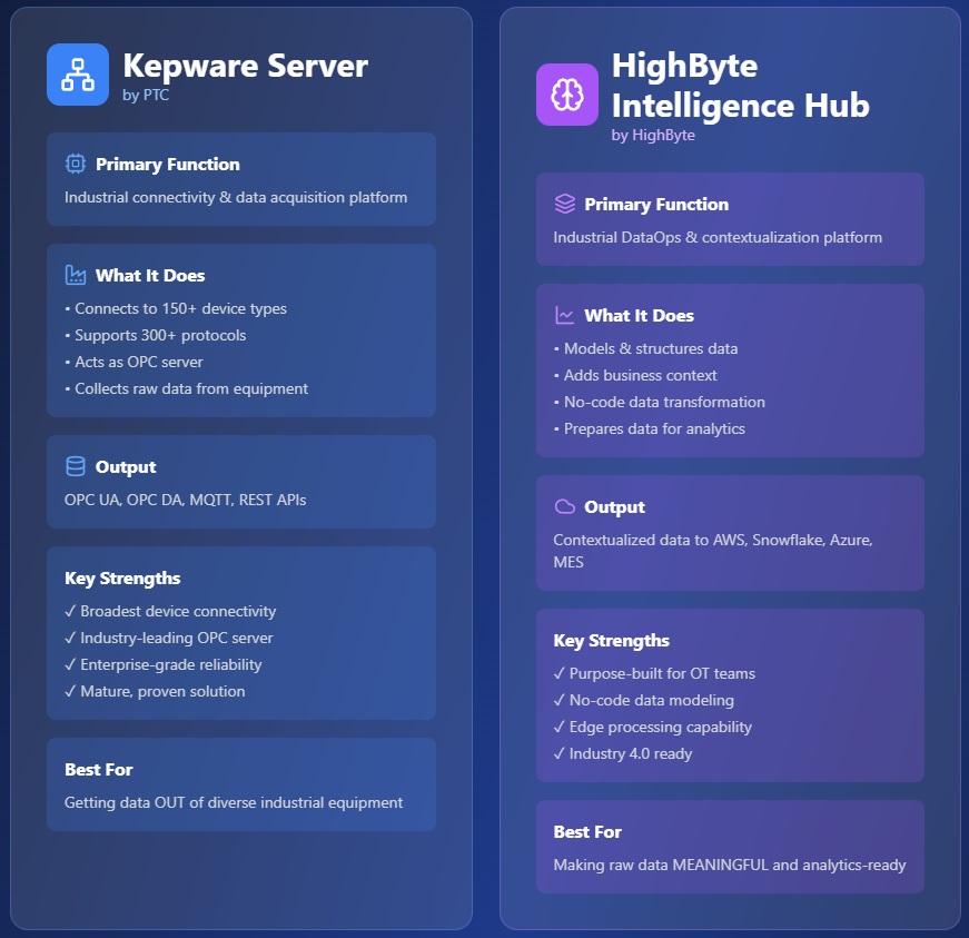

Let’s compare two common industry platforms that serve these two tasks.
 Figure 2. Comparison of the kepware and HighByte.
Kepware Solves the Connectivity Challenge
Kepware specializes in connecting to industrial equipment.
Pre-built drivers eliminate custom programming
Instead of writing code to communicate with each machine type, you select from 150+ pre-built drivers. Need to connect to a Siemens S7-1200 PLC? There's a driver. Allen-Bradley ControlLogix? There’s a driver. Modbus, FANUC, Mitsubishi, Omron—all covered. This turns weeks of programming into mere hours of configuration.
Centralized management across multiple facilities
In a multi-plant operation, managing connections to thousands of machines becomes overwhelming. Kepware’s cloud-based control panel lets you configure, update, and monitor all your connections from one place—whether you have one small shop floor or 5,000 machines spread across 50 sites. When you need to update security settings or add new connections, you do it once rather than traveling to each location.
Standardized output formats
All those different machine protocols get converted to industry-standard formats: OPC UA (the modern industrial connectivity standard) and MQTT (popular for cloud applications). Your downstream systems only need to understand these two protocols instead of dozens.
HighByte Adds Context and Organization
Raw machine data alone doesn’t tell you much. HighByte transforms that data into actionable information.
Building reusable templates for similar equipment
When you have 20 identical machines, you shouldn’t have to configure data 20 different times. HighByte lets you create a template—defining what data matters, how to calculate metrics like cycle time or throughput, and what context to add—then apply it across all similar equipment. Change the template, and all 20 machines update automatically.
Adding business context automatically
HighByte enriches technical data with business meaning. A sensor reading becomes “Temperature on Line 3, Building A reached 185°F at 2:45 PM during production of Part #X1234.” This context makes data immediately useful for operators, engineers, and business analysts who don’t speak in register numbers and protocol addresses.
Calculating meaningful metrics at the source
Rather than sending millions of raw data points to the cloud and calculating metrics there (expensive and slow), HighByte processes data at the edge. It calculates production counts, identifies downtime, computes OEE (Overall Equipment Effectiveness), and only sends the results. This dramatically reduces data costs and makes information available instantly.
Managing data quality and governance
HighByte tracks what data came from where, applies validation rules, handles missing or bad data gracefully, and maintains version control. When someone questions a production report six months later, you can trace exactly how that number was calculated.

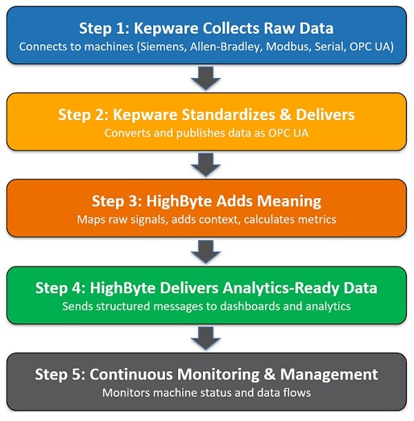

How They Work Together: A Practical Example
Let’s walk through a real-world scenario: monitoring production quality across a packaging line.
Step 1: Kepware collects the raw data
Kepware connects to five different machines on your packaging line: a filling machine (Siemens PLC), a capping machine (Allen-Bradley PLC), a labeler (Modbus device), a weight checker (proprietary serial protocol), and a vision inspection system (OPC UA). Each connection is configured through Kepware's interface in minutes using pre-built drivers.
Step 2: Kepware standardizes and delivers
All five data streams get converted to OPC UA and published on your network. Now everything speaks the same language and follows the same data structure.
Step 3: HighByte adds meaning
HighByte reads the OPC UA data and applies your packaging line model. It knows that register 1045 is “number of units filled,” and register 2031 is “number of rejects.” It combines data from all five machines, adds context (line number, product SKU, shift), calculates quality metrics, and detects when reject rates exceed thresholds.
Step 4: HighByte delivers analytics-ready data
Instead of sending millions of raw data points, HighByte sends structured messages like: “Line 3 completed 15,243 units of Product SKU-789 during Shift 2, with 1.2% reject rate (183 units), primarily at the capping station.” This formatted data flows to your dashboard, quality database, or cloud analytics platform—ready for use right away.
Step 5: Continuous monitoring and management
Kepware’s central management console shows all five machine connections are healthy. HighByte’s monitoring shows data flowing correctly through each processing step. When you replicate this line setup to three other facilities next quarter, you copy the existing configuration rather than starting over.
 Figure 4. The flowchart of data usefulness.
