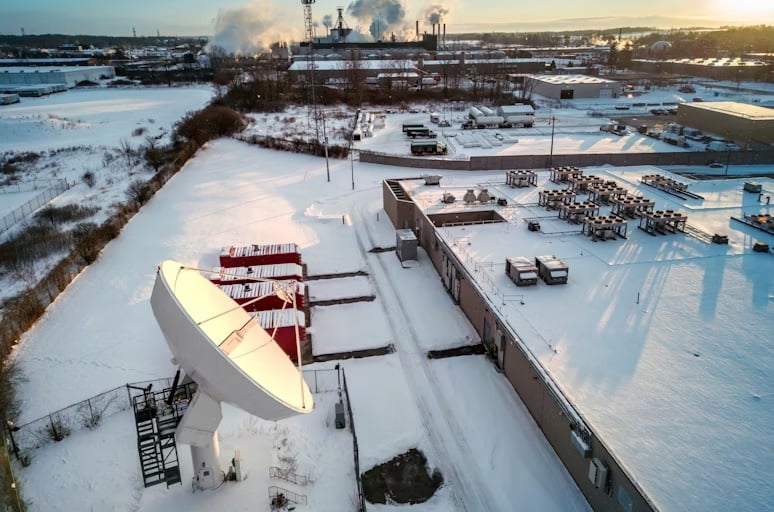

 Figure 2. A remote facility where communication is unreliable.
Figure 2. A remote facility where communication is unreliable. Image used courtesy of Unsplash

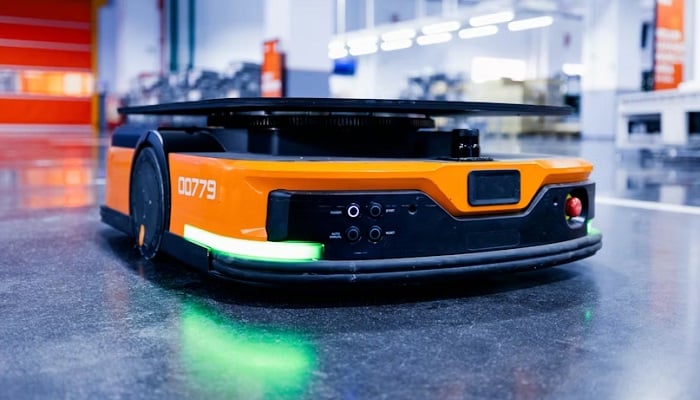

 Figure 3. An AMR that uses OPC UA to communicate with a fleet manager.
Figure 3. An AMR that uses OPC UA to communicate with a fleet manager. Image used courtesy of Unsplash

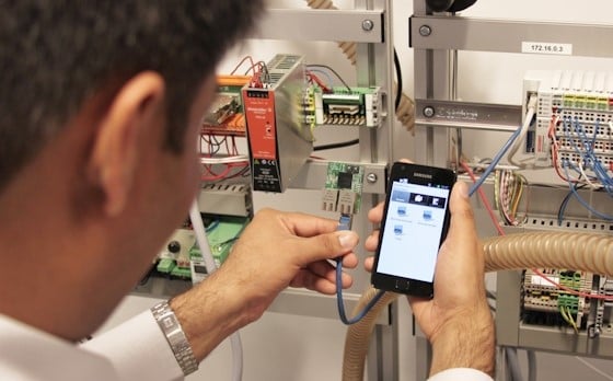

 Figure 4. A technician uses OPC UA sensor data to cloud systems.
Figure 4. A technician uses OPC UA sensor data to cloud systems. Image used courtesy of Wikipedia
