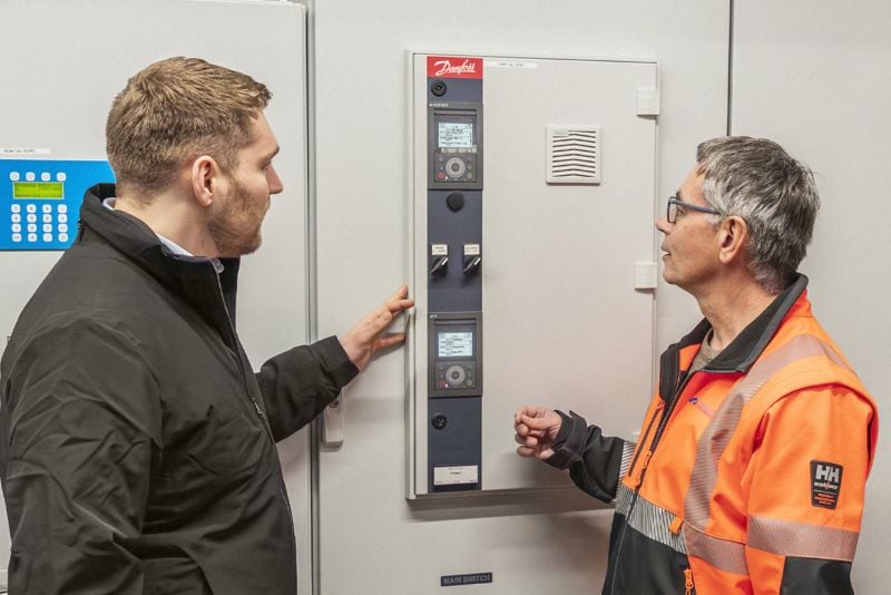

Danfoss has built its iC7-Aqua VFD for water management systems
Danfoss has built its iC7-Aqua VFD for water management systems. Image courtesy of Danfoss

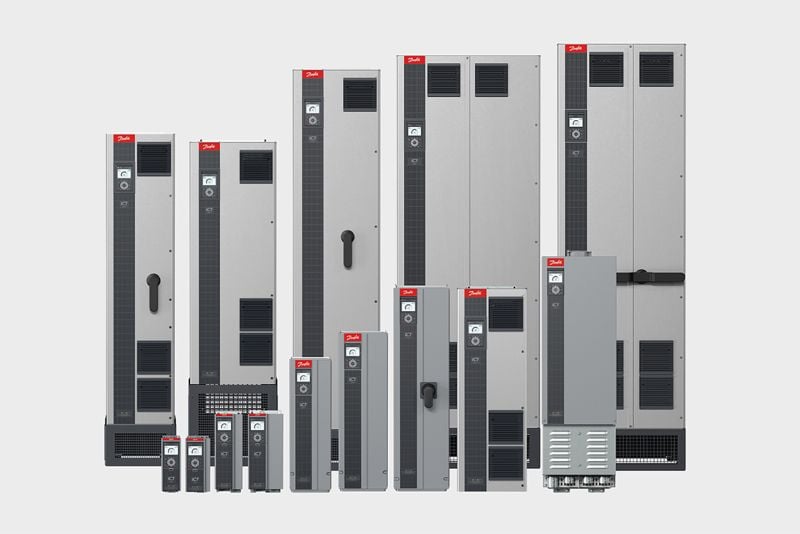

The iC7-Aqua VFDs feature built-in protection functions specifically engineered for water pumping applications
The iC7-Aqua VFDs feature built-in protection functions specifically engineered for water pumping applications. Image used courtesy of Danfoss
