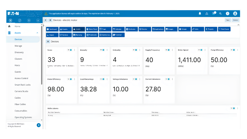

The motor analytics software relies on real-time data, including motor speed, efficiency, voltage, and load percentage
The motor analytics software relies on real-time data, including motor speed, efficiency, voltage, and load percentage. Image used courtesy of Eaton

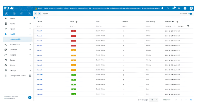

The motor analytics software uses predicted failure modes to make maintenance recommendations based on the system's condition
The motor analytics software uses predicted failure modes to make maintenance recommendations based on the system's condition. Image used courtesy of Eaton
