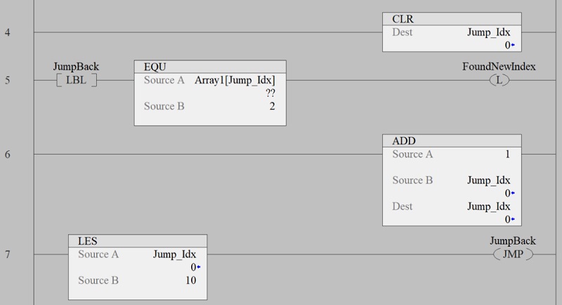

Scanning With Jump/Labels
A jump is a special function that will alter the scan of the PLC, so it must be used with caution. When the PLC executes a jump, it will move the program pointer to the label of the same name. This label can be forward or backward in the logic. For every jump, there needs to be a corresponding label with the same name. The name of the jump/label is not a tag and doesn’t need to be created, but the label name does need to be unique, and a label must be the first object on a rung.
If we have the same array as before, Array[0..9], we can use the jump/label logic to create a loop that will index our pointer, allowing us to loop through our array. Using the same indirect logic as before, we can evaluate new data with every increment of the pointer; the difference being we don’t have to wait for the scan of the PLC for the next index. Once the evaluation logic is complete and the program pointer has executed the jump, the program pointer will jump back to the label, and the evaluation logic will execute again, this time with the new index position.
In this style of looping, we place a reset at the top, before the label, and we condition our jump with a less-than compare block. So as long as our pointer is in the range of the array size, we keep jumping back.
 Figure 3. Looping with jumps.

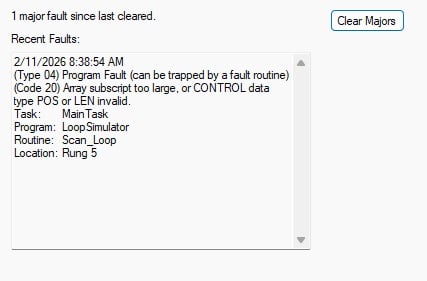

Whenever you are using indirect addressing on array variables, you run the risk of faulting the processor.
Typically, there are two faults: data overrun and watchdog timer. Both of these faults refer to an issue with your loop instruction, and if you get either of these faults, the PLC program stops executing, and all the outputs turn off.
 Figure 4. A fault in a scan cycle.

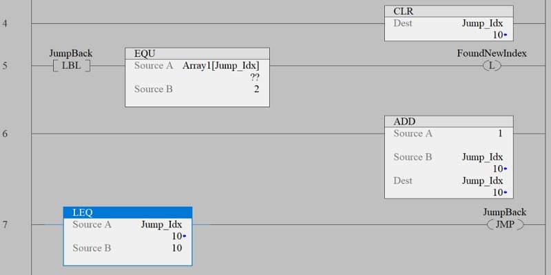

The data overrun faults happen when the pointer is outside of the array length, so in our earlier example (which used an index range of 0 to 9), if the pointer reached 10 and we tried to evaluate an indirect tag, we would receive a processor error.
Loops with jumps are prone to watchdog faults. This happens when the scan time of the PLC has been slowed down beyond a threshold. This can happen if you have too many loops in a routine or you have multiple nested loops with no exit condition, creating an endless loop. While a processor fault doesn’t sound horrible, they can cause damage if the conditions are just right.
 Figure 5. This is a loop that would cause a fault.

  • One of the simplest tricks is to add extra placeholders in your arrays. If you only need five indexes, make the array seven or even ten in length. A couple more indexes will occupy more memory, but might save you from a process or error.
  • Another tip is to limit your nested loops; it is easier to debug multiple loops than nested loops. Try to move multidimensional array data into an intermediate array to prevent nested loops.
  • Keep your index increment above your compare block. This way, you always add one to your index and then compare if you are outside of the array, and the actual size of the array can be used when comparing instead of the zero-based size of the array.
