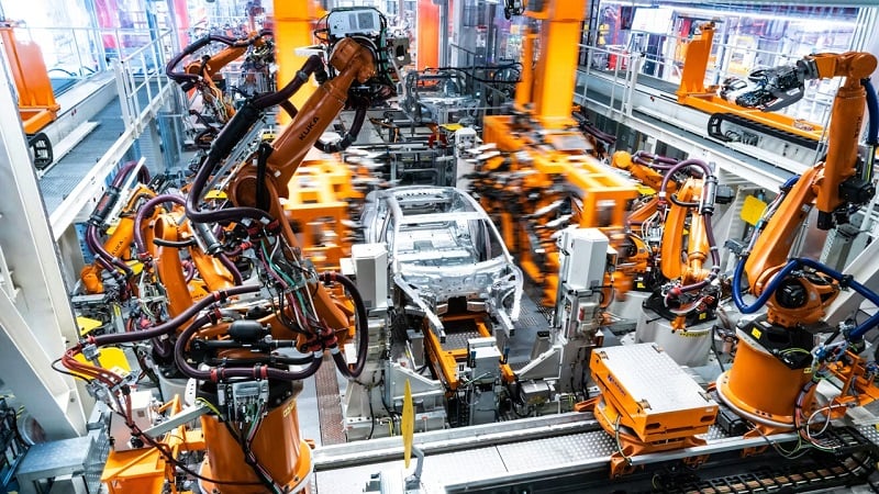

A virtual control system, or vPLC, is a software-based PLC that is installed on an industrial server located somewhere on the network. While these systems are not new, they are gaining popularity with advancements in computer technology and the growing demand for IIoT solutions. With Siemens' release of the S7-1500V virtual PLC, integrators and factories have been building entire automated assembly lines with virtual PLCs, including Audi, with the official release of its Edge Cloud 4 production line. (source: Edge Cloud 4 Production: IT-based factory automation enters series production | Audi MediaCenter)
 Figure 1. Automobile manufacturing using virtual PLCs in production equipment.
Figure 1. Automobile manufacturing using virtual PLCs in production equipment. Image used courtesy of Siemens

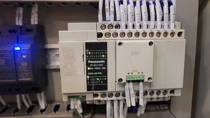

In most control cabinets around the world, you will find a PLC, the brains behind controlling I/O and automating your process. PLC hardware has grown over the years, especially over the last 10-15 years, when they have benefited from multicore processors similar to those found in PCs, but still custom-designed for automation.
A virtual PLC is software-based and resides in an industrial computer or server. This software uses the high-end internal processor for processing the programmed logic. So, why use a vPLC if a standard PLC has custom-designed processors and is built for automation?
 Figure 2. A common PLC installed in an electrical cabinet.
Figure 2. A common PLC installed in an electrical cabinet. Image used courtesy of Wikimedia Commons

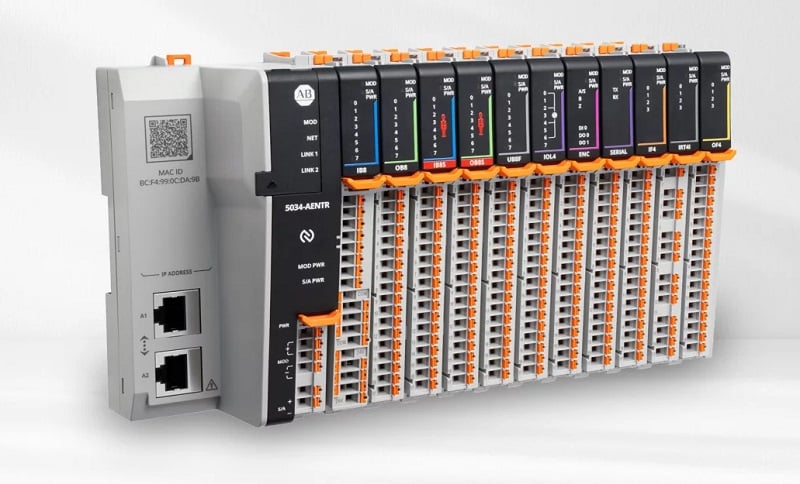

 Figure 3. Allen-Bradley Point I/O system.
Figure 3. Allen-Bradley Point I/O system. Image used courtesy of Rockwell Automation
I/O Architecture Overview
Virtual PLCs run on industrial PCs or servers that are hosted on the network, but how does that change the architecture of the I/O within the equipment? For the most part, it doesn’t. Most field I/O today uses some type of fieldbus communication technology such as Ethernet/IP, PROFINET, or Modbus TCP. All of these protocols use the Industrial Ethernet infrastructure that IT systems use for network communications.

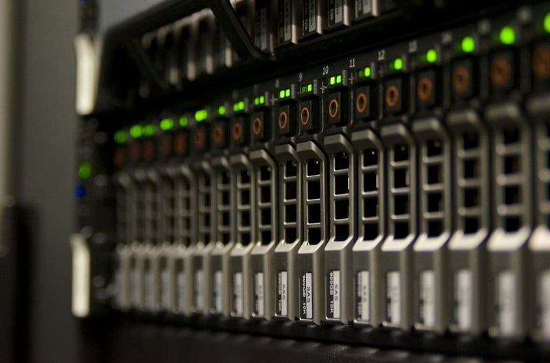

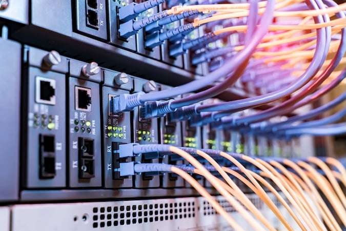

A standard PLC is designed and built by automation companies for the automation industry. They often withstand harsh conditions such as high heat, dust, or moist environments. Servers, even industrial servers, are designed for inconsequential processing tasks. If a server task fails, someone might lose a connection to their data, but if a task fails in a PLC, someone could lose a life or limb. PLCs are built to be rugged and deterministic. The Siemens family of processors has dual redundant processing capabilities to ensure there is no data loss during power outages. Typical servers do not have this type of functionality, so that should be weighed when choosing the right kind of hardware to host a virtual PLC. Keep it in a safe location, or ensure that it is built to withstand harsh conditions.
 Figure 4. An industrial server with multiple drive slots that could be used to run a virtual PLC.
Figure 4. An industrial server with multiple drive slots that could be used to run a virtual PLC. Image used courtesy of Unsplash

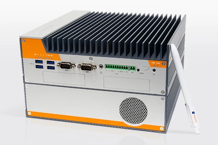

 Figure 5. OnLogic industrial edge server.
Figure 5. OnLogic industrial edge server. Image used courtesy of OnLogic
