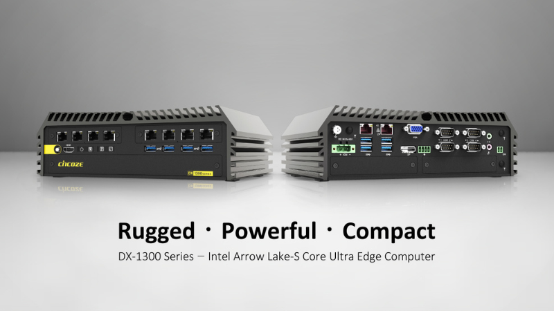

Cincoze recently introduced the DX-1300, a compact and powerful industrial PC designed for edge computing in environments where space is limited and processing needs are increasing. Powered by Intel Core Ultra 200S processors, this latest addition to Cincoze’s Diamond line delivers up to 36 TOPS of AI computing performance. It supports demanding applications such as real-time analysis, machine vision, and multitask data processing.
The Cincoze DX-1300 is a compact, rugged industrial computer designed for high-performance edge AI applications
The Cincoze DX-1300 is a compact, rugged industrial computer designed for high-performance edge AI applications. Image used courtesy of Cincoze

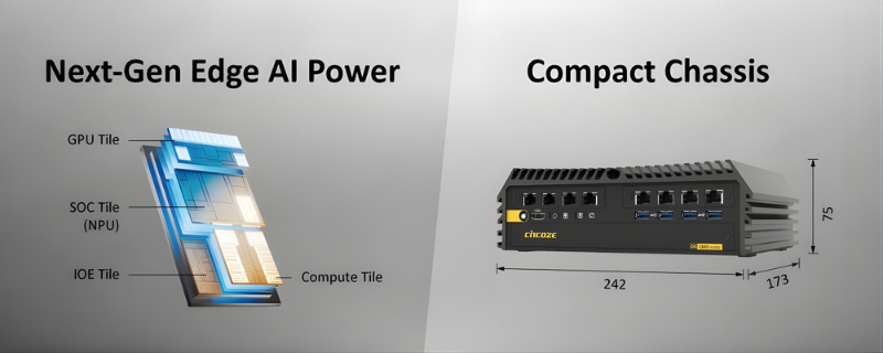

Cincoze’s new DX-1300 industrial computer features a compact size (242 mm × 173 mm × 75 mm) that fits easily into tight industrial spaces without requiring changes to existing layouts. It is also ideal for distributed edge deployments where space for new computers is limited. Cincoze has designed its computing solution for durability, with a fanless, cable-free build that reduces mechanical wear. This design helps ensure low-maintenance operation, even in hard-to-reach environments.

The DX-1300 uses Intel's Arrow Lake-S Core Ultra 200S platform, which combines CPU, GPU, and NPU resources in a single architecture. This setup allows the system to assign tasks to the most suitable processor for efficient AI performance. With up to 36 TOPS, which is 3.5 times faster than previous models, it is designed for latency-sensitive edge applications such as real-time video analysis, automated inspection, and industrial data processing.

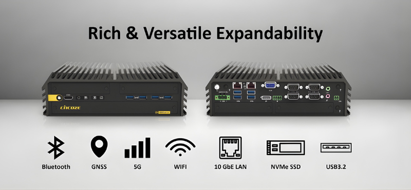

The DX-1300 offers flexible expansion options, including M.2 key B and key E slots for adding wireless modules such as Wi-Fi, 5G, and GNSS, making it suitable for mobile and remote applications. It supports both high-speed NVMe SSDs and large-capacity SATA drives, with modular interfaces for I/O, security, and power management.
For vision tasks, the computer supports up to 12 LAN ports or 8 PoE ports, allowing multi-camera setups without extra hardware. The DX-1300 also provides Ethernet options including 10 GbE, 2.5 GbE, and 1 GbE, as well as USB 3.2 ports for high-resolution imaging and real-time processing. M12 coded connectors ensure secure connections in environments with vibration or harsh conditions.
