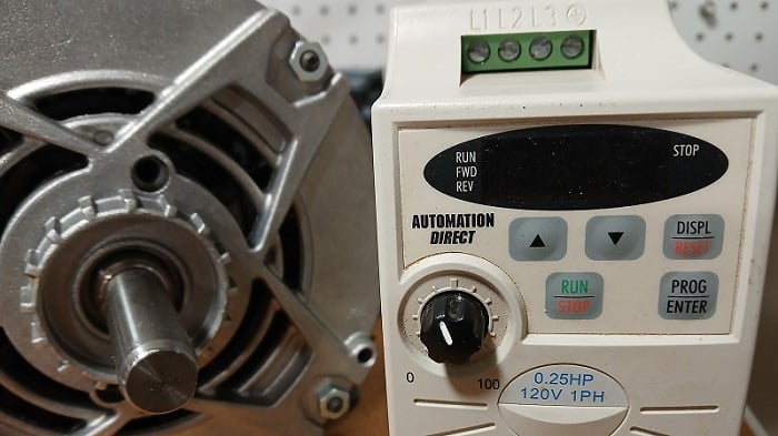

What is VFD control? Input terminals of a VFD for single-phase line inputs
Figure 1. The VFD is responsible for driving many 3-phase motors.
Notice in the above figure, we see only two screw terminals plus the green ground. This arrangement indicates a single-phase input. Also, the small network port is for RS-232 communication, not Ethernet control in this case.
