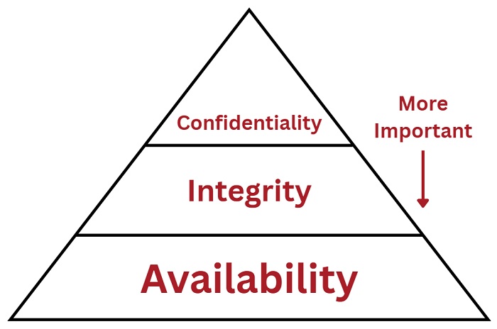

 Figure 2. Cyber triad as it appears for OT frameworks.
OT Availability
For OT networks, the triad is typically represented in a reverse direction, or AIC. The attributes are the same as for the IT triad, but the priority order is changed. For industrial controls, the primary goal is availability: keeping the system or physical process in service, like a generator transformer, grid, or control system, in a running state.
OT Integrity
The data must be accurate and consistent. For example, an incorrect wicket gate or limit position on the governor control system may lead to the unit tripping.
OT Confidentiality
This attribute is less prioritized in the OT system. Many old legacy systems are still using legacy protocols, like Modbus RTU/ASCII, which lack data security features. OT systems are designed for availability, reliability, and safety purposes, leaving data confidentiality as an afterthought.

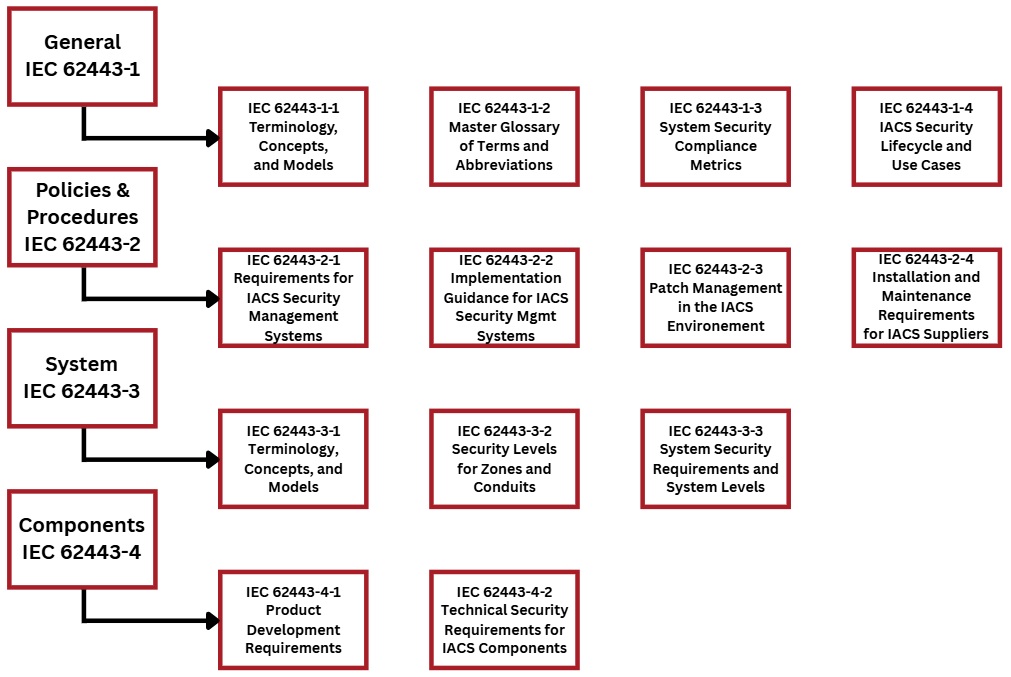

The ISA/IEC standard defines the roles of organizations, policies, and processes. The ISA/IEC 62443 Framework is a four-tier framework and has the following sections, denoted by suffixes 1 to 4. All sections have multiple sub-sections as shown in Figure 2.
General
This section gives an overview of the framework and defines the terminologies, concepts, and abbreviations.
Policies & Procedures
This section provides guidelines for creating and maintaining a secure industrial control system by adopting security policies and risk management. This is helpful for the asset owner.
System
The system standard section guides by including the cybersecurity technologies and methods for IACS. This section is quite relevant to system integrators.
Components
This section covers industrial life cycle development for products and components, and is primarily intended for device manufacturers.
 Figure 3.
Figure 3. IEC 62443 framework for securing critical OT infrastructure.
