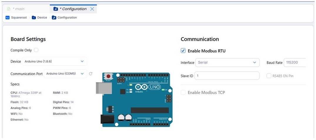

To utilize the debugger, the Arduino Uno PLC must be properly configured within the OpenPLC editor. The appropriate firmware is selected, and the communication port is assigned to establish a connection between the development machine and the controller. The Modbus RTU communication protocol is enabled, and a Slave ID is entered to support data exchange.

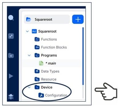

Once the ladder diagram is downloaded to the Arduino Uno PLC, a debug session is initiated by selecting the bug icon within the editor interface. During execution, the transmit and receive LEDs on the Arduino Uno will flash, indicating active communication between the controller and the OpenPLC editor. Figure 2 shows how to access the configuration settings panel for hardware device selection and communication setup.
 Figure 2. The Configuration Settings panel.
The selection of the Arduino Uno and the Modbus RTU communication setting is shown in Figure 3.
 Figure 3. Configuring the Arduino Uno board and Modbus RTU communication.

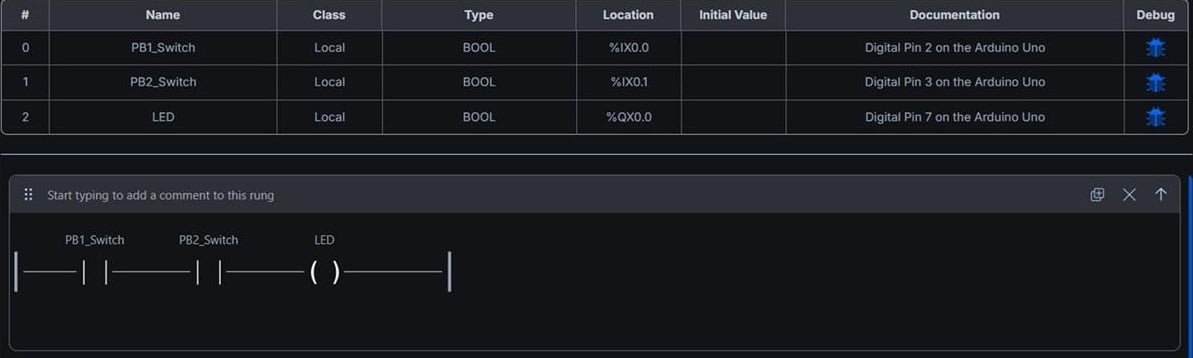

A basic AND logic gate can be used to illustrate the operation of the debugger in OpenPLC version 4.1.2. The ladder diagram consists of two input devices, PB1_Switch and PB2_Switch, connected in series using Examine If Closed (XIC) instructions. An Output Energize (OTE) instruction is used to control an LED based on the input conditions.
The LED will only turn on when both input devices are activated. The simple logic structure of the AND logic gate ladder diagram (LD) and tag listing provides a clear example of real-time monitoring.
 Figure 4. AND logic LD and tag listing.

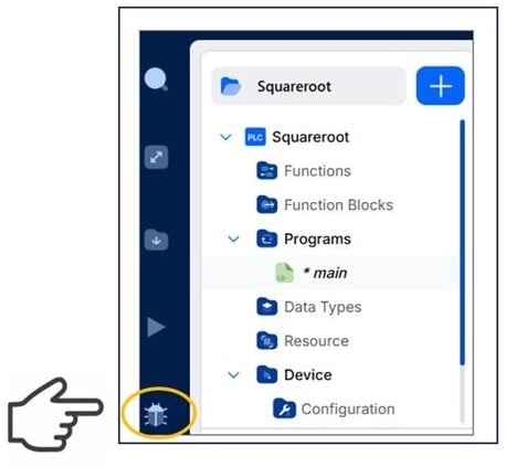

To implement this example, the watch window is configured to display the status of PB1_Switch, PB2_Switch, and the LED output. Figure 5 illustrates the location of the OpenPLC bug icon.
 Figure 5. OpenPLC bug icon.
The debugger allows the logical behavior of the AND gate to be observed in real time. When both input devices are in the FALSE state, the LED remains OFF. When only one input device is activated, the LED remains OFF because the AND condition is not satisfied. When both PB1_Switch and PB2_Switch are activated, the LED changes to the ON state. This behavior is displayed immediately in the watch window, confirming correct logic operation.
