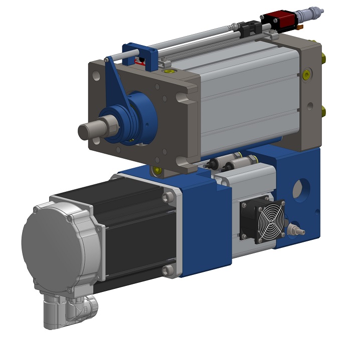

David: Let's begin with the basics: How do hybrid linear actuators work? How do they compare to the more familiar methods of purely electric or purely hydraulic actuators?
Carl: Hybrid linear actuators combine the power and robustness of hydraulics with the precision and controllability of electric actuators. A compact, fluid-based cylinder (similar to a hydraulic cylinder) is directly integrated with a servo motor and gear pump (like an electric actuator) to create linear motion. Standard PID control still applies.
 Figure 2. A hybrid linear actuator with the servo-driven pump (at the bottom) and the linear motion component (top).
Figure 2. A hybrid linear actuator with the servo-driven pump (at the bottom) and the linear motion component (top). Image used courtesy of Kyntronics
Actuator Operation
  • Extension: The motor rotates the pump in one direction to extend the piston rod.
  • Retraction: The motor reverses direction to retract the piston rod.
  • Control: Integrated position sensors or limit switches provide real-time feedback, ensuring precise and repeatable movement. An optional pressure transducer is used to measure the force exerted by the piston rod.
Hybrid actuators enable programmable positioning, speed regulation, and load monitoring, making them ideal for automation and Industry 4.0 applications. Hybrid linear actuators also offer several operational advantages, including power-on-demand energy efficiency compared to traditional hydraulic systems, a sealed design that eliminates external reservoirs, filters, and hoses, and the durability and tolerance needed to handle applications that have shock and side-loads.
Traditional hydraulic systems typically rely on a centralized hydraulic power unit (HPU) that runs continuously at maximum speed and pressure. Flow is then directed through valves and servo valves to the cylinders via hoses and plumbing. This approach can lead to significant energy waste and can introduce leak points throughout the system.

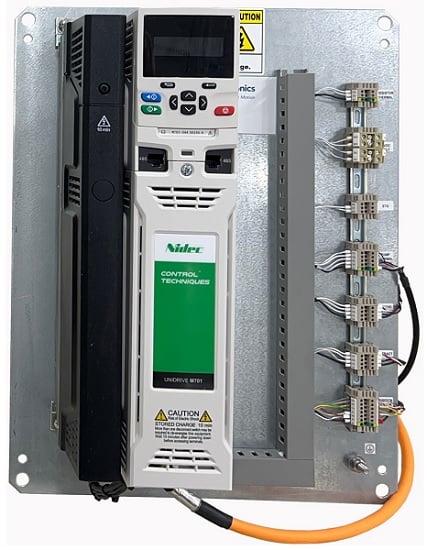

David: How do they interface with a control system? Would the integration experience feel more like a VFD-driven pump, or a servo controller?
Carl: From a controls and integration standpoint, hybrid actuators behave more like a servo-controlled electric system. In most cases, the actuator is driven by a standard servo motor and servo drive, allowing it to integrate easily with modern motion platforms and industrial automation systems that already support servo control.
 Figure 3. The drive unit for a hybrid linear actuator.
Figure 3. The drive unit for a hybrid linear actuator. Image used courtesy of Kyntronics
Hybrid linear actuators are also flexible in terms of motor selection. While AC servo motors are commonly used, the system can be configured with a range of motor types, including DC servo motors, induction motors, or other motor technologies, depending on the application requirements and control preferences.

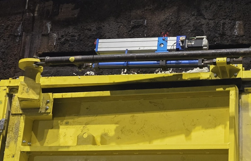

 Figure 4. A hybrid actuator used in a mining application.
Figure 4. A hybrid actuator used in a mining application. Image used courtesy of Kyntronics
Hybrid actuator technology is also highly adaptable. The combination of servo-controlled motion with hydraulic force generation allows engineers to address a wide range of actuation needs, including applications that require precise positioning, controlled speed profiles, or substantial force output.
