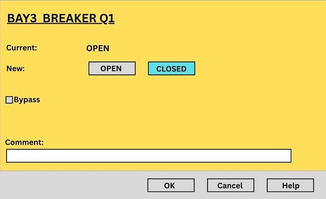

  • When the operator selects the breaker, a small pop-up dialogue window appears, waiting for confirmation of the command from the operator.
Different dialogs or pop-up window templates are provided for various control devices; the following are a few examples:
Open/Close: Open/close command buttons to the breakers and isolators.
 Figure 1. Example of an Open/Close dialog box.
Figure 1. Example of an Open/Close dialog box. Image used courtesy of the author

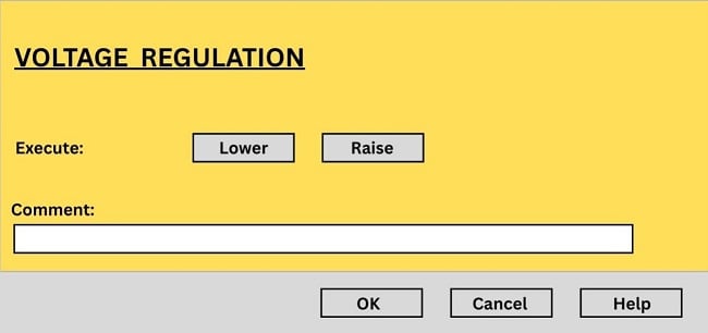

Raise/Lower: Used to raise/lower pulses to the speed level adjustment, wicket gate limit/position, and voltage regulation, etc. The advantage is the step-by-step regulation of the process instead of abrupt changes in regulation.
 Figure 2. Example of a gate Rasie/Lower dialog box.
Figure 2. Example of a gate Raise/Lower dialog box. Image used courtesy of the author

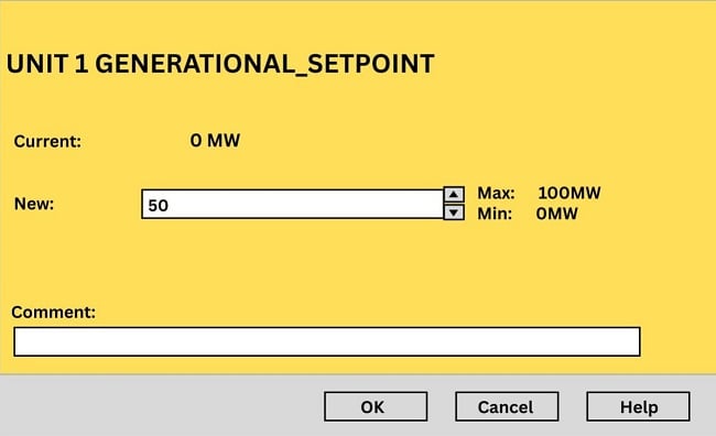

Set-point: The operator can enter the MW (Megawatt) set point for individual generating units or a group of units.
 Figure 3. Example of a numeric set-point dialog box.
Figure 3. Example of a numeric set-point dialog box. Image used courtesy of the author

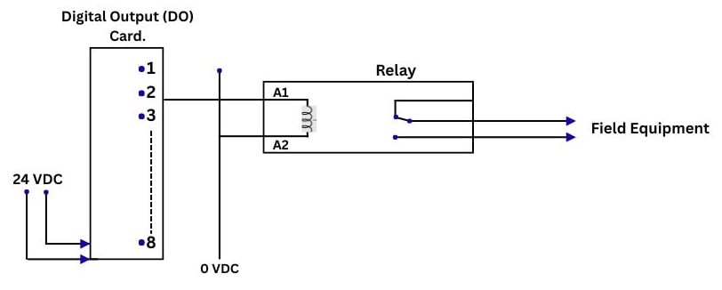

The first operation method is to use a DO card to implement the command issued by the operator from the operator workstations. This scheme may include the following components from top to bottom, on how commands are routed to the field.
  1. The operator clicks on the GUI page to open/close the line isolator.
  2. From the software/server, the command is received at the RTU/PLC level.
  3. The DO card activates the respective channels for the control object.
  4. An interposing relay and its contacts are used to operate high-voltage devices.
  5. Interlocking is also hardwired while opening and closing the breaker.
  6. In the end, the breaker/isolator is opened or closed.
  7. The feedback status of the breaker is also reported back to the main SCADA system, so that the control object is made ready for the next command.
 Figure 4. Handling of the command using the DO card and the interposing relay to operate the field equipment.
Figure 4. Handling of the command using the DO card and the interposing relay to operate the field equipment. Image used courtesy of the author
