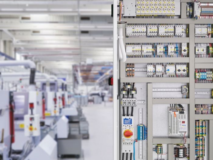

Sensitive electronics in industrial control panels, machine power systems, and renewable energy installations are vulnerable to damage from voltage spikes. Even brief surge events can degrade insulation, disrupt control logic, or trigger costly shutdown.
Phoenix Contact’s VALVETRAB Safe Protection Plus family stands as a potential solution to address these demands by combining equipment-level surge protection with installer-focused safety enhancements, supporting higher operational availability in modern electrical systems.

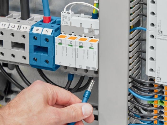

The new VAL-SPP devices include miswiring protection to prevent incorrect connections during setup, touch protection to keep technicians safe when working with live electrical enclosures, and a low torque requirement of just 3 Nm to help avoid mounting mistakes or mechanical stress.
The new units also feature reinforced insulation, providing additional protection for people and connected systems. Every plug features a built-in mechanical status indicator, allowing overloaded protective plugs to be identified directly on-site.
VAL-SPP’s plug-in modular design simplifies wiring, enabling faster and safer installation in control cabinets
VAL-SPP’s plug-in modular design simplifies wiring, enabling faster and safer installation in control cabinets. Image used courtesy of Phoenix Contact
Plug-In Remote Signaling Simplifies Maintenance
To make maintenance easier, the VAL-SPP devices offer modular, plug-in remote signaling. This lets operators check surge protection status without extra wiring or interruptions. This approach can save time in large industrial setups where surge protection modules need regular replacement. A quick-disconnect feature also improves safety in the event of a fault or surge.
