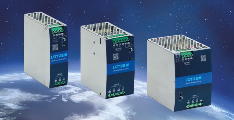

LUTZE’s LEPOS power supply series offers a balanced mix of reliability, efficiency, and practicality for industrial control systems. Available in five ranges covering 20 to 960 watts, the lineup includes 12V and 24V models with up to 94% efficiency and built-in protection for overload, overvoltage, and heat. Designed for easy installation and global compatibility, LEPOS delivers stable DC power for automation panels and control cabinets—robust, efficient, and ready to handle demanding environments.
Introducing the LEPOS series power supply line from Lutze.
Introducing the LEPOS series power supply line from Lutze. Image used courtesy of Lutze
Lutze designed its new LEPOS power supply series for standard industrial use. The line offers dependable DC power for control cabinets, machines, and automation panels. The series includes both 12-volt and 24-volt models, with power outputs ranging from 20 to 960 watts, covering nearly any application. Each unit in the LEPOS lineup is designed with reliability in mind. The supplies reach efficiencies as high as 94 percent, keeping heat low and minimizing energy waste. They’re built to handle short circuits, overloads, and temperature spikes without dropping output, even sustaining 150 percent of their nominal rating for short bursts. Models range from 1 amp to 40 amps and include options for parallel or redundant setups. All units utilize screw terminals, carry a UL 508 Listing, meet RoHS compliance, and offer a high mean time between failures, making them easy to maintain and long-lived in the field.

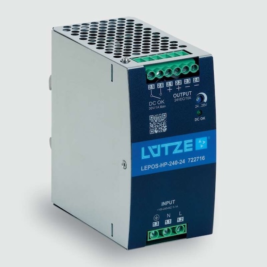

Each LEPOS model uses a switch-mode design with broad AC and DC input compatibility, making system integration straightforward. The power supplies are equipped with adjustable output voltages for easy fine-tuning during setup. Every unit features built-in protection against overload, overvoltage, and overheating, providing users with the core safety features expected in industrial power systems.
Each power supply carries adjustable output voltages for fine tuning.
Each power supply carries adjustable output voltages for fine tuning. Image used courtesy of Lutze
Installation is also simple. LEPOS units share common form factors and terminal layouts, allowing engineers to install or replace them without redesigning panels. From small 60-watt models to the largest 960-watt versions, consistency across the line helps standardize installation and maintenance.
