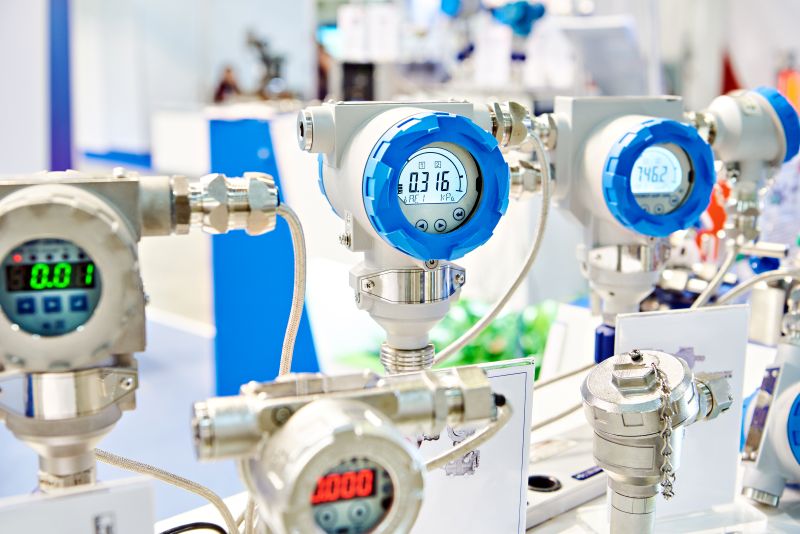

SPE technology is widely used for communications across industrial and process industries to save on cost and space
SPE technology is widely used for communications across industrial and process industries to save on cost and space. Image used courtesy of Adobe Stock
