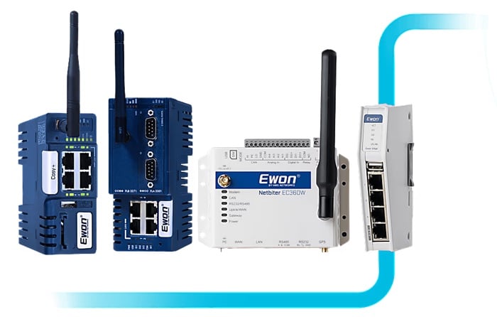

 Figure 2. A collection of remote gateways from HMS networks (EWON).
Figure 2. A collection of remote gateways from HMS networks (EWON). Image used courtesy of HMS Networks

EWON - A popular gateway often used by OEMs to allow for remote diagnostics. A software suite is used to configure and connect to the gateway, with cloud options available. The interface is intuitive and easy to use.

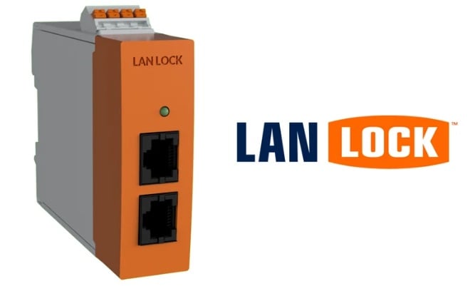

Most gateways have built-in software security features, while others have software and hardware inputs to control when a connection can be achieved. Some of the EWON models have digital inputs that can be configured to literally, physically enable or disable remote connection. These digital inputs can be connected to a physical key switch or a PLC output.
 Figure 3. An Ethernet isolating device for customer-controlled VPN access.
Figure 3. An Ethernet isolating device for customer-controlled VPN access. Image used courtesy of LAN LOCK

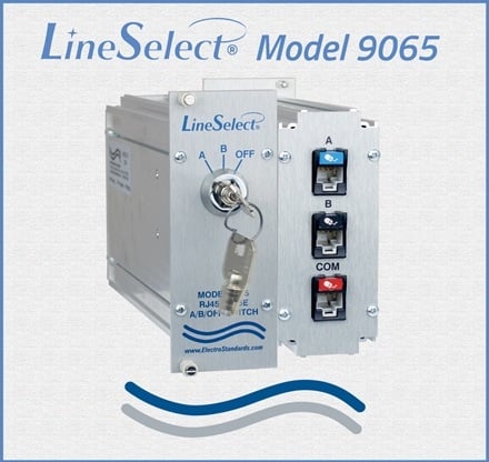

Gateways that lack a built-in disconnect feature can use devices like the LAN LOCK from Envision. This device has digital inputs that, when energized by a relay, PLC, or HMI, will isolate the connection between the two ports, essentially acting like a physical disconnect. A similar device from ElectroStandards includes a keyswitch and allows a user to select an alternate network or to completely disconnect the connection.
 Figure 4. An Ethernet switching and isolating device.
Figure 4. An Ethernet switching and isolating device. Image used courtesy of ElectroStandards
These devices provide the customer with a physical disconnect which they control, thus adding another layer of protection.
