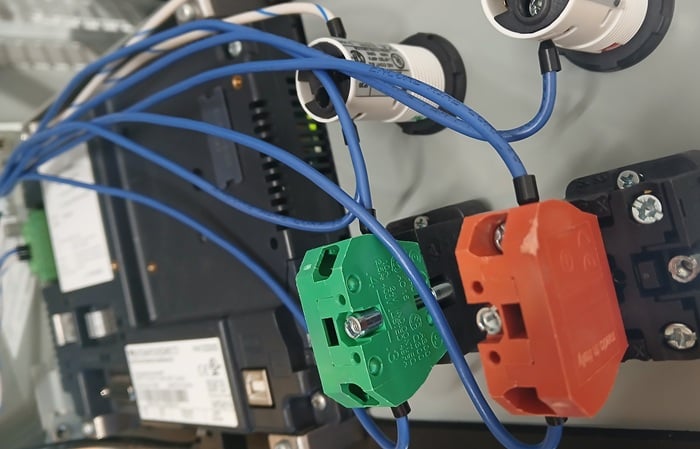

Pressure Wire Terminals
This category includes any connection where the bare wire is inserted and tightened by screw force. Examples of this kind of connection are bus bars in an electrical panel, screw-down terminal blocks, lever-action terminal connectors, and power distribution blocks with screw lugs.
Multiple connections into a single terminal are allowed as long as the connection is reliable and no strands of the wire were cut or moved out of the way so the wire could fit.

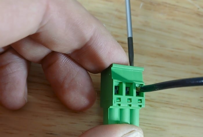

Quick-Connect Terminals
Two main connector types fit in this category. First, the type that are opened by the lever arm force of a thin, flat screwdriver and then the force is released to clamp down on the wire. Second, the new types of push-in connectors where the inserted wire presses on a trigger and activates a spring-loaded clamp.
Neither of these methods rely on the pinching action of a screw against a plate. However, they still must include some element of a dimpled or ridged plate so that the actual part that provides the clamping force isn’t just a flat plate against the wire.

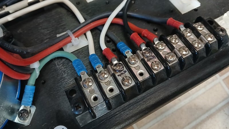

Closed-Loop Eyelets
These connectors are similar in shape to the ring terminals used by automotive technicians, and they are quite common on grounding screws and multi-point distribution bars. The terminals may be crimped to the end of the wire, and when the end of the terminal is a closed eyelet, the screw is trapped. Unless the screw comes completely disconnected, the wire cannot slip off.

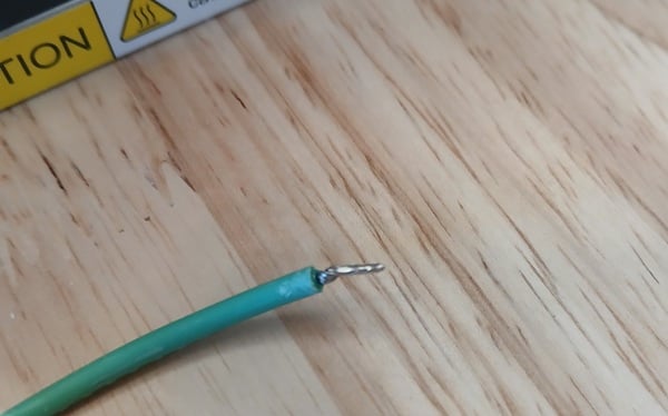

Soldered Connections
A soldered connection is more permanent, so it’s less likely to be encountered in panel assembly. But it is allowed under a few conditions. Before soldering, the wire must be wrapped at least halfway around a screw terminal, or have at least one right-angle bend if it’s passed through an opening, or, if it’s just a wire-to-wire connection, it must be wrapped around the other conductor.

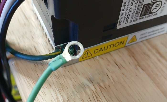

Wire-Binding Screws
These wire-binding screws are the type you see on residential outlets and light switches. They are also common on earth-grounding screws inside motor drives and enclosures. The wires can be fitted with terminals that have eyelets, like the section above. They can also be used with soldered ends of stranded wire, as is common on grounding screws. They can also be used with solid wire, provided that it is wrapped at least ¾ of the way around the screw.
It is against the UL guide to simply bind down on the stripped, unterminated end of a stranded wire.

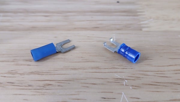

Open Eyelet
The closed-loop eyelets trap the screw and cannot come free easily. If the eyelet is open (like fork-end terminals), the wire can come loose if the screw vibrates just a fraction of a turn. These types of terminals can be accepted as long as they have upturned ends, or the ends somehow support and grip the screw shank so that it cannot disengage unless the screw physically comes out of the device.
