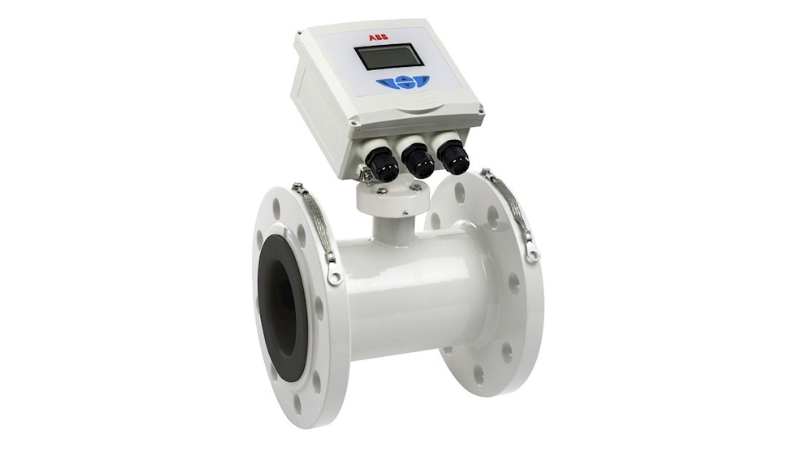

The FER620 low-flow flowmeter has a fully sealed housing
The FER620 low-flow flowmeter has a fully sealed housing. Image used courtesy of ABB
Accurate Low-Flow Measurements
The ProcessMaster FER620 is the latest addition to ABB’s ProcessMaster flowmeter product line, designed specifically for water and wastewater treatment plants. The FER620 has a fully welded body and is hermetically sealed. Combined with an IP68 rating, this fully welded design allows the sensor to function even when completely submerged.
Processing plants will often try to reduce energy consumption during off-peak hours by reducing pump speed. The FER620 remains highly accurate even in low-flow scenarios, thanks to its reduced-bore sensor with a high turndown range.
The FER620 uses the industry-standard HART for communication and also includes self-diagnostic features, such as sensor coil and electrode diagnostics, built-in noise and ground checks, and automatic configuration. These features help reduce downtime by ensuring the flowmeter is working at optimal efficiency from day one.

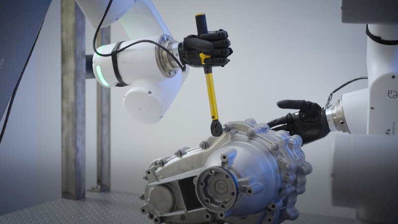

Psyonic’s Ability Hand mounted on ABB’s GoFa robot performing human-like tasks
Psyonic’s Ability Hand mounted on ABB’s GoFa robot performing human-like tasks. Image used courtesy of ABB
Advanced Robotic Dexterity
Humans have dexterity in their hands, which helps perform delicate tasks that might require skill and coordination; robots, on the other hand, do as they are programmed. ABB has partnered with PSYONIC, a California bionics company, to use real-world data from human prosthetics to give robots an advantage in developing human-like dexterity. The PSYONIC Ability Hand will interface with ABB’s collaborative robot, the GoFa, and provide motion data to enable the robot to perform delicate and complex tasks without complex robot programming.

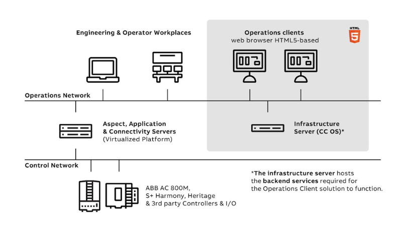

ABB’s Ability System 800xA DCS now features web browser-based operations
ABB’s Ability System 800xA DCS now features web browser-based operations. Image used courtesy of ABB
Web-Based Process Control and Analysis
The automation world has been shifting to web browsers rather than standalone HMI PCs for quite some time now, and the process automation industry is following suit. ABB’s flagship DCS, the ABB Ability System 800xA, has already begun the process with its extension pack upgrade, which allows for the monitoring, analysis, and control of industrial processes from a secure web browser.
By upgrading software via an extension pack, ABB can push features and upgrades without requiring customers to download and install new software. These extension packs reduce large-scale upgrade events and lifecycle costs, enabling customers to adopt new digital features at their own pace.
