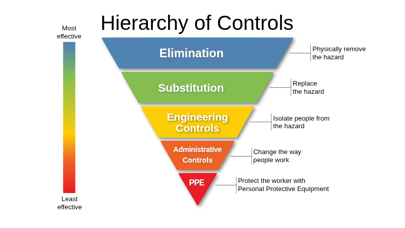

The Hierarchy of Controls
The Hierarchy of Controls. Image courtesy of Wikipedia
The Role of Locking Safety Switches
Safety engineers often refer to the Hierarchy of Controls, which ranges from the most effective control mechanisms to the least. At the top is elimination; eliminating the hazard completely is the most effective method. At the bottom is personal protective equipment (PPE), which is a last resort in a safety plan.
Locking safety switches, such as Idem’s new HLZ heavy-duty guard locking safety switch, are a type of engineering control. Once installed, they are passive; the technicians do not need to do anything to activate them. They remain latched until a specific set of conditions is met, preventing exposure to hazardous conditions. As an engineering control, safety switches are much more effective than an administrative control, such as an SOP or policy.

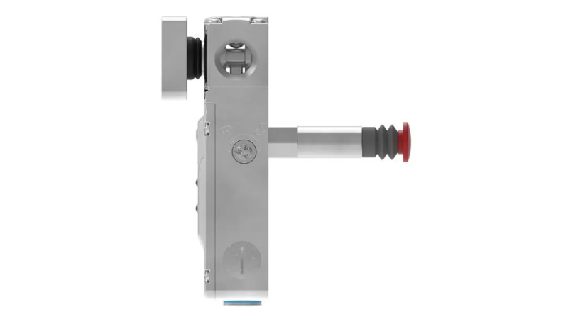

Idem’s HLZ heavy-duty guard locking safety switch features up to a 10 kN holding force
Idem’s HLZ heavy-duty guard locking safety switch features up to a 10 kN holding force. Image courtesy of Idem Safety
HLZ Heavy-Duty Guard Locking Safety Switch
The HLZ series locking safety switches can withstand up to 10 kN of force before failure. Once it is locked, it will remain locked until the proper conditions are met. This makes it suitable for heavy doors, large lids, and enhanced machine guards where a lighter lock simply will not hold.
Should it be used on heavy doors, it can be supplied with an optional backside release. For example, if it is used on an industrial oven, and a worker gets trapped inside the oven, they can pull the release and escape.
The switch itself can be connected with M20 or M12 connectors. It has OSSD safety outputs rated to Category 4, Performance Level e, and SIL 3, indicating a very low failure rate, even with a system fault present. It continuously monitors for fault conditions as well.
Another key feature of the HLZ is its durability in harsh and challenging environments. The HLZ is rated to IP69K, meaning it is dust-tight and suitable for use in steam and high-pressure water environments.

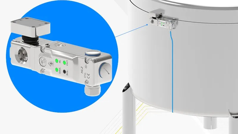

Idem’s HLZ includes an optional rear escape release
Idem’s HLZ includes an optional rear escape release. Image courtesy of Idem Safety
Safety in Harsh Environments
Numerous applications require heavy holding force. What makes the HLZ special is the IP69K rating. Idem Safety designed this lock specifically for harsh applications, including those in the food and beverage and pharmaceutical industries. Given the high IP rating, this lock is suitable for washdown applications and clean-in-place and steam-in-place cleaning and sanitization work, which has become standard for these industries.
