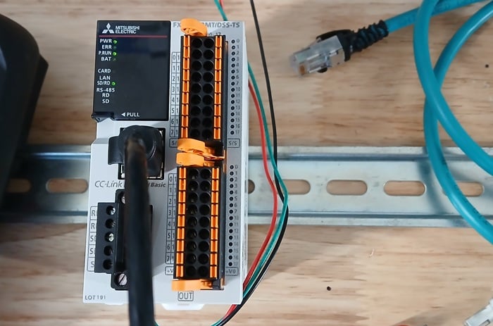

Our hardware is the FX5UC PLC, a compact form factor with inputs and outputs embedded onto the front. This PLC can only be programmed with an Ethernet connection, so we have two options, and the choice will make a difference later:
  1. Connect directly from your PC to the PLC with an Ethernet cable.
  2. Connect both the PC and the PLC to a network switch. It’s fine if there is other equipment connected, perhaps a motor drive, HMI, etc. In my own setup, there are three different PLCs and some other I/O equipment on this same network.

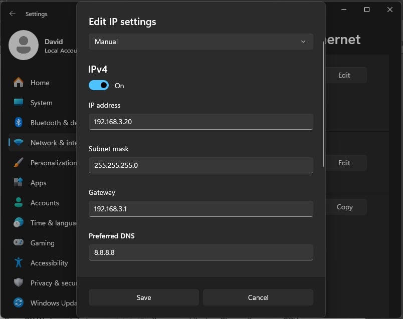

These PLCs arrive from the factory with an IP address of 192.168.3.250. If your PC (and all the rest of your equipment) is on a different network, you will need to connect to the PLC and change the address.
Go to your PC network settings and change your IP address to the same subnet: 192.168.3.xxx.
 Figure 2. Editing the PC’s IP address in Windows 11.

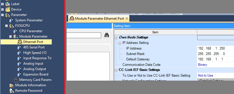

On this left side, expand Parameter -> (CPU type) -> Module Parameter and double-click on Ethernet Port. In this location, we can set our own IP address which will be set into the PLC after a download and restart.
 Figure 4. Editing the controller’s IP address.

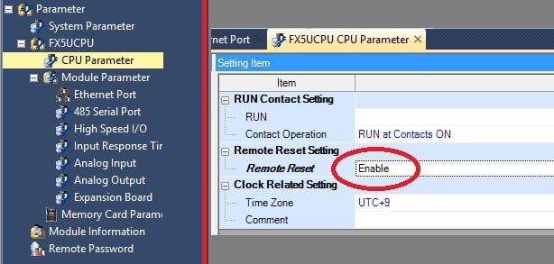

Note on remote reset: After downloading, you can cycle the power manually, but if you wish to reset the PLC remotely, expand Parameter -> (CPU type) and double-click CPU Parameter. Open the Operation Related Settings, and enable the remote reset option.
 Figure 5. Enabling the remote reset function.

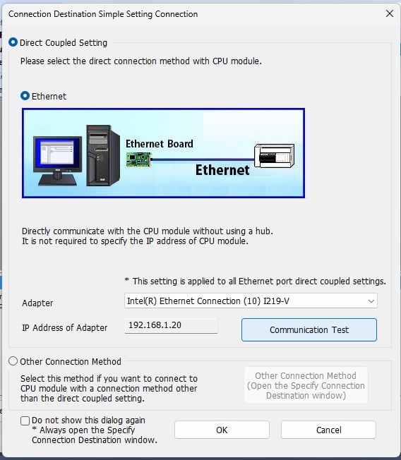

Now we need to select how the PC is linked to the PLC. From the top menu, select Online -> Current Connection Destination
Now, we need to go back and review those two network topologies that we presented earlier.
  1. If you connected the PLC to the PC directly via an Ethernet cable, and no network switch is involved, then select Direct Coupled Setting and choose your network adapter from the drop-down menu.
     Figure 6. Direct point-to-point com setup.

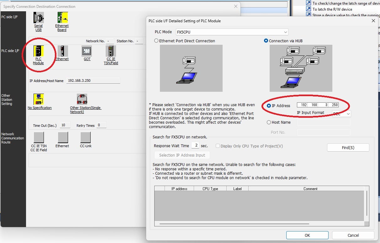

  1. If, like me, you are connecting to the PLC through a network switch, then select Other Connection Method, double-click on PLC Module in PLC side I/F, select Connect via Hub, and enter the IP address (at this point, the PLC is still the default 192.168.3.250). Click Find.
     Figure 7. Connection through a switched network.

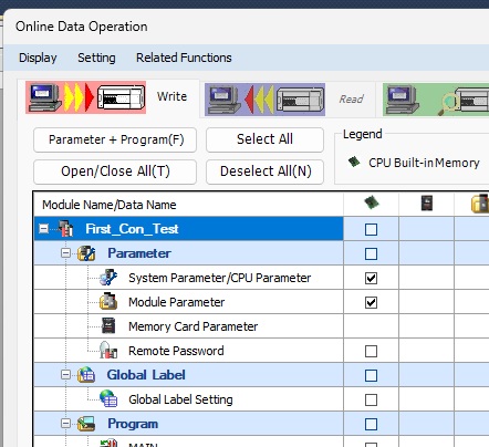

Now that the changes are ready, they need to be downloaded (written) to the PLC. At the top, go to Online -> Write to PLC and select the proper CPU parameters.
 Figure 8. Write to PLC button.
Since we changed the reset setting and provided a new IP address, we must at least select System Parameter / CPU Parameter and Module Parameter. Now Execute, and follow the dialog to download the configuration.
 Figure 9. Selecting elements to write to PLC.

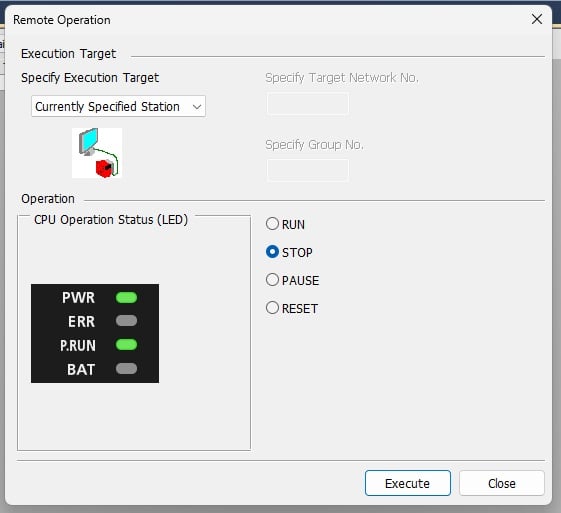

Even after the download is complete, the IP address hasn’t really been altered yet. It requires a restart or a reset for that to happen. You can manually power cycle the CPU, but now you can also navigate to Online -> Remote Operations and select Reset.
 Figure 10. Resetting the PLC remotely.
