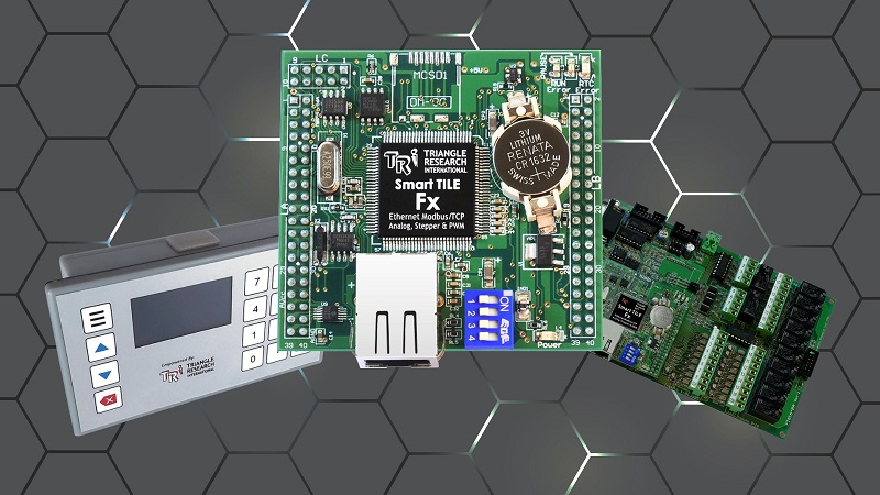

Figure 1. TRi PLC products, including the Wx Series (left), the SmartTILE controller (middle), and the Fx Series carrier board (right).
This exact model is the Fx2424, which has 24 digital input and digital output points, as well as 8 analog inputs and 4 analog outputs.

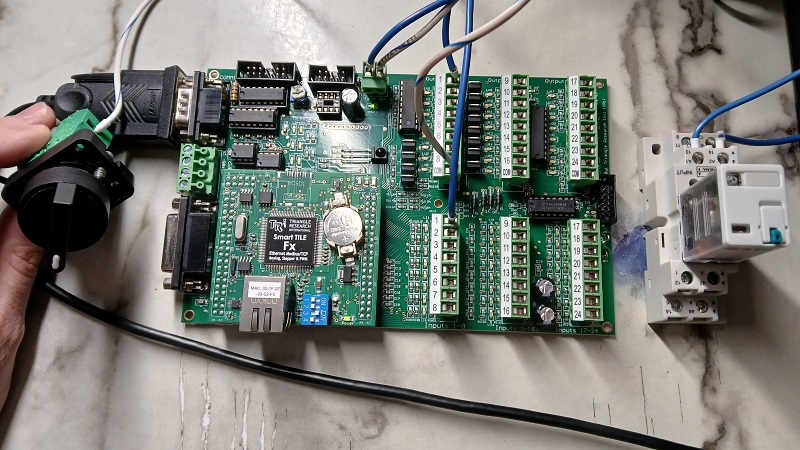

 Figure 2. The complete project hardware: power, a serial cable, an input switch (left), and a relay (right).
1) Power the Board
Connect power to the header near the power LED. This header is marked with +24 V and 0 V.
2) Connect the Switch
Since the inputs are sourcing, we must run a wire from 0V of the supply to the switch, then out from the switch to the terminal marked 1 on the Inputs 1-8 header bank. Again, no common power connection is needed, since it receives a small amount of input current from the power header.
If the PLC and the switch are powered from the same supply, this will work just fine as-is. If they are on different power supplies, you must connect the 0 V terminals of both supplies to establish a common return path.
3) Connect the Relay
Since the outputs are sinking, we run a wire from +24 V of the supply to terminal A1 of the relay, then out from the relay terminal A2 to terminal 1 of the ‘Outputs 1-8’ header.
Since outputs require more current than the inputs, a common connection is required for the outputs. This COM terminal on the output header must be connected to 0 V of the load power supply.

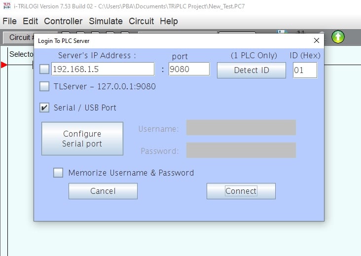

Use a USB-to-Serial cable and connect COMM1 of the PLC to your computer. A device driver should automatically install on a Windows PC and be assigned a COM port number. Check your device manager to verify the COM port number.
Open the i-TRiLOGI software and open the Controller menu at the top. Select Connect to Server. From the listed options, select Serial/USB Port, then Configure Serial Port.
Figure 3. Connecting to the PLC.

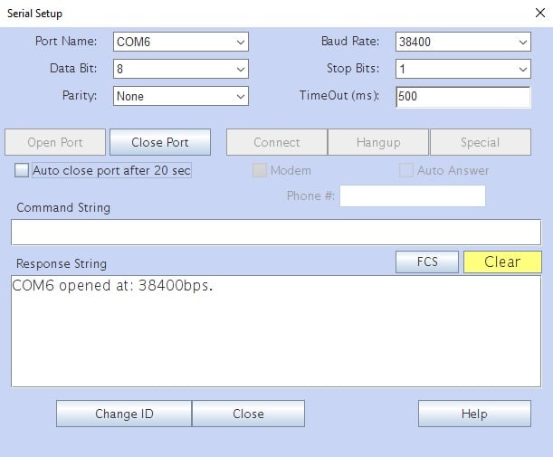

In this Serial Setup window, you may need to change the port if several devices are connected, but it should already be properly selected. Click Open Port, and the response string window should reflect that the port was opened.
 Figure 4. Opening the serial COM port.
Now close the Serial Setup window and the Detect ID window. If the hex ID autofills with a number, you can connect to the PLC.

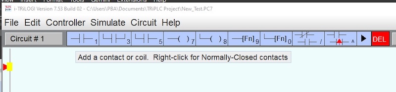

To write a simple ladder program, double-click in the green workspace near the red arrow, indicating the top ladder rung. At this point, a menu of commands will open along the top bar.
Figure 5. Adding instructions to the ladder rung.

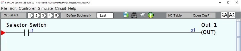

Click on the normally open contact numbered 1 (alternatively, just press 1 on the keyboard). The I/O table will open, and you may select from an already-named terminal or assign a new name to a new terminal for convenience. If you chose the wrong terminal, no problem. Simply click to highlight the command, right-click, and rename or pick a new point from the I/O table.
Repeat this process to add an output coil (or press 7). The points can be selected from the table or renamed in a similar manner to the inputs.
Figure 6. Complete program.

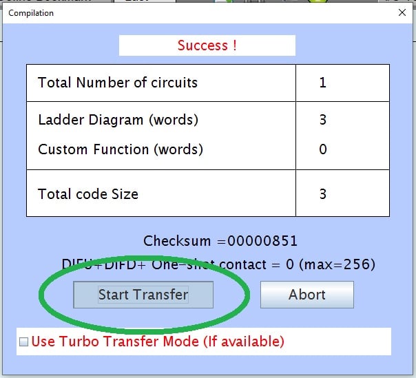

After the program finishes, select Controller -> Program Transfer to PLC from the menu bar. Depending on your exact order of operations, you may need to identify the serial port again (see paragraphs 3-4 in the previous section). If successful, you can transfer the program, and the window should report a successful transfer.
 Figure 7. Program transfer to PLC.
