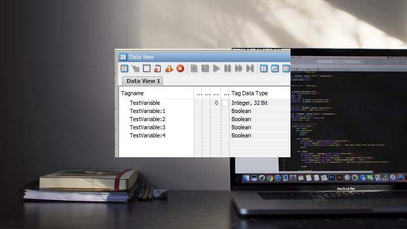

 Figure 1. Laptop and tag listing with dot notation.
Figure 1. Laptop and tag listing with dot notation. Image (modified) used courtesy of Unsplash

To address integers at the bit level in Studio 5000, you simply reference the tag that is an integer type (DINT, by default), then add a “.” after the variable name and attach a number to represent the individual bit. With this syntax, you can now use boolean operators on the specific bit. In some programming languages, the notation may use a “:” symbol, but the strategy is the same.
In the example logic rung below, there is a DINT called TestVariable in the tag list. This variable is used to monitor whether various conditions have occurred, even momentarily. This one TestVariable DINT can store up to 32 different latchable conditions. Since this is a single variable, all of the conditions can be viewed at once in the tag listing.

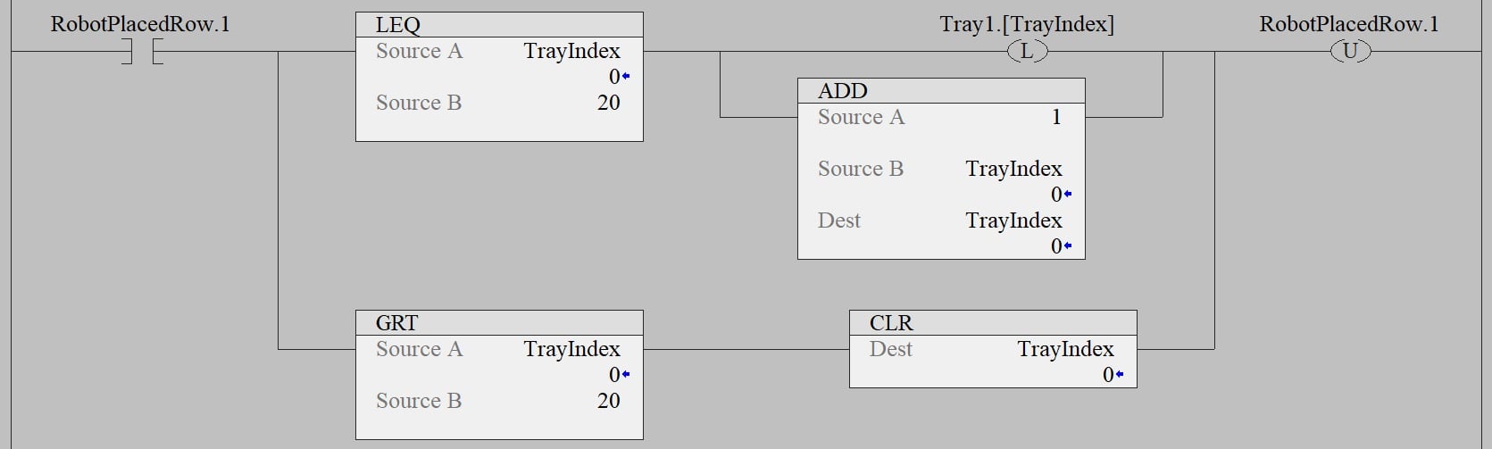

In some situations, you may want to programmatically change which bit level your dot notation is referencing. This can be done with specific syntax. Just like before, type the name of the variable and add the “.” at the end. Now, add square brackets “[]” with a new integer variable inside those brackets. As the value of the variable inside the brackets changes, the bit level will change.
 Figure 3. Indirect referencing of a bit inside an integer.
Figure 3. Indirect referencing of a bit inside an integer. Image used courtesy of the author
Indirect referencing is often used for counting, and although there are counters already available, one counter consumes more memory than the two DINTs in this example.

A common place to use dot notation is palletizing or tray handling. In these cases, you need to track how many parts you have placed and where they were placed. If we take a tray, for example, that has 20 pockets by 5 rows, and every time the robot places a part in a pocket, we can latch a bit representing the pocket. This way, if the robot program gets reset, the PLC will still know where parts have been placed or not placed.
We could create a user-defined type consisting of 20 boolean variables. We could then assign 5x variables with the new type. This solution would create five variables with a memory size of 640 bits each, totaling 3200 bits (or 400 bytes).
 Figure 4. Sample program that uses indirect referencing to fill a Tray1 integer, showing current status from trays 0-20 before resetting.
Figure 4. Sample program that uses indirect referencing to fill a Tray1 integer, showing current status from trays 0-20 before resetting. Image used courtesy of the author
Alternatively, using dot notation, we could create five variables again, but this time each variable would be one DINT. Our new memory size would be only 32 bits per variable. With 5 variables, the total consumption is 160 bits, or 20 bytes.
