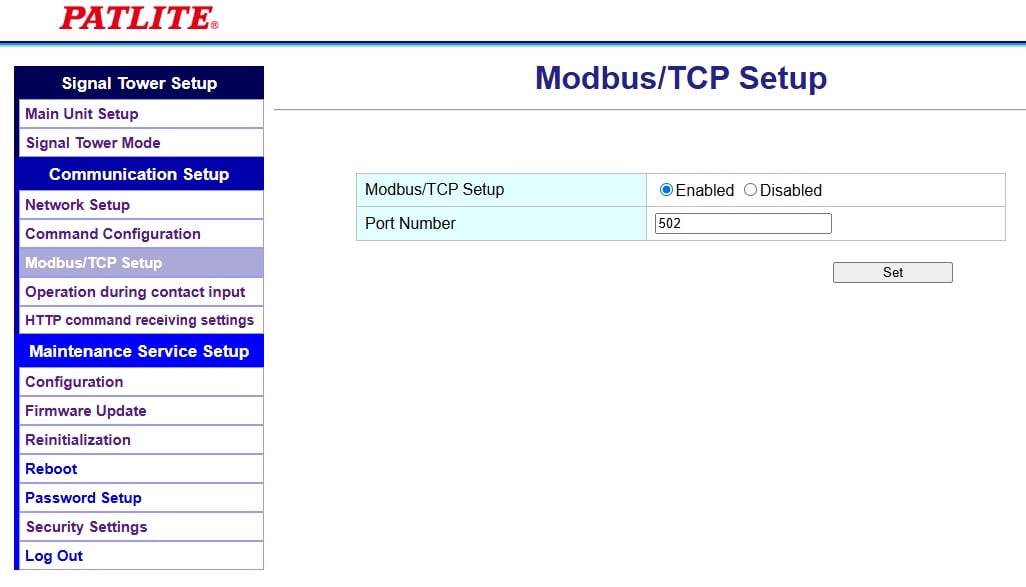

When the tower light is powered and connected to a PC via Ethernet cable, the web server can be accessed. The default IP address is 192.168.10.1, and on first setup, a password is created. You need to set the IP address to the same subnet as the Modbus PLC. In the Modbus menu, be sure that it’s enabled, and you can leave the default port at 502.
 Figure 2. Verifying Modbus communication.

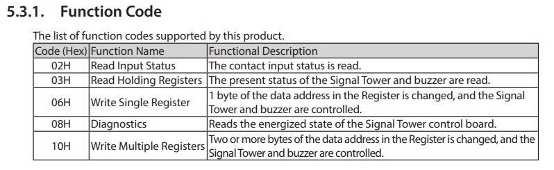

What function codes can be used?
 Figure 3. Valid function codes for this product.
From the table above, we can read both contacts and registers, but we can only write to registers. This means that, to turn lights on or off, we must use function codes 6 or 16.

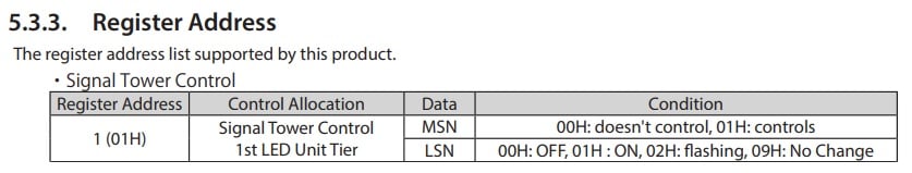

If registers are used for outputs, what values should be placed into the registers?
If coils had been used for outputs, we would simply use boolean tags to write a 1 or a 0. But a register is a 16-bit integer, so we must have detailed information about which values will create a response. In this stack light, we can turn the lights on, off, or flashing, so we need more than just 1 and 0 coils.
 Figure 4. Command and control byte data.
According to the table above, we see that the first register address needs to be sent bytes to control the light, and to turn it on. To control the light, bytes 01, then to turn it ON is also 01. In binary, as a 16-bit integer, this is:
0000 0001 0000 0001
Converted to decimal, this equals 257.
Likewise, to turn the light off, send 01 00, which is 0000 0001 0000 0000, equaling 256.
If we want to flash the light, send 01 02, which is 0000 0001 0000 0010, equaling 258.

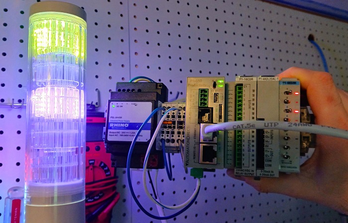

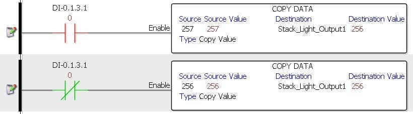

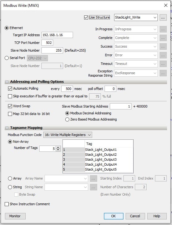

First, most AutomationDirect PLCs use a similar format: a MWX (Modbus Write) command. In the Productivity Suite environment, we need to define tags that will hold the values for the registers. In this example, I used some toggle switches that populate integer tags with either a 257 or a 256.
 Figure 5. Adding data to the tags.
Once the tags are populated, the MWX command directly writes the message to the Modbus device.
 Figure 6. Modbus write parameters.
The Modbus device IP is added, while port and node numbers stay at default values.
Automatic polling is added so that the rung of logic doesn’t need an input. 500 ms is a sufficiently high frequency for this task.
The starting address is 1 for the top stacklight level, in accordance with the documentation.
To use the tags, the function code is 16 (multiple registers to control all tiers at once). The tags come from the toggle switches in the previous lines.
Once this code is downloaded, the lights respond exactly as expected!

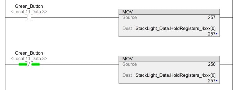

For a Rockwell Studio 5000 code, we can use the readily available AOI from the download center. Extract the folder and ‘import rungs’ to use the Modbus TCP client instruction. When created, the name of the tag will be Client_01 by default, but you can Find/Replace all tag instances to ‘StackLight,’ or to a better name.
Everything required for the Modbus transmission is contained in the tags.
First, the data to be sent to the Modbus registers should be populated. For simplicity, we’ll use the same strategy as the previous example. Press a button to light up the tier, release the button to turn it off. The MOV command sends a 257 or 256 into the appropriate Data.HoldRegisters tag.
 Figure 7. MOV commands to add data to the tags.

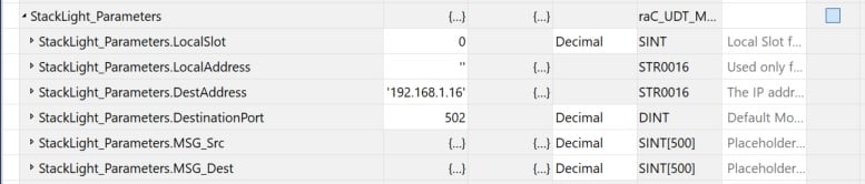

Next, we need to set the destination IP address for the device. This PLC has a single embedded Ethernet port, so it does not need a local address.
 Figure 8. Tags to set up the communication.

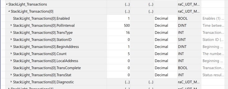

Finally, set up the transaction (message) details. I set the poll interval to 500 ms. The transaction type is 16, meaning ‘write multiple coils.’ The beginning address is 1, and there are 5 integers to be sent. Remember, those integers were defined in the Data.HoldRegisters tags.
 Figure 9. Tags to set up the message details.
When we set this Transaction.Enabled tag to 1 and are successfully online, the stack light should reflect the values as assigned in the HoldRegisters tags!
