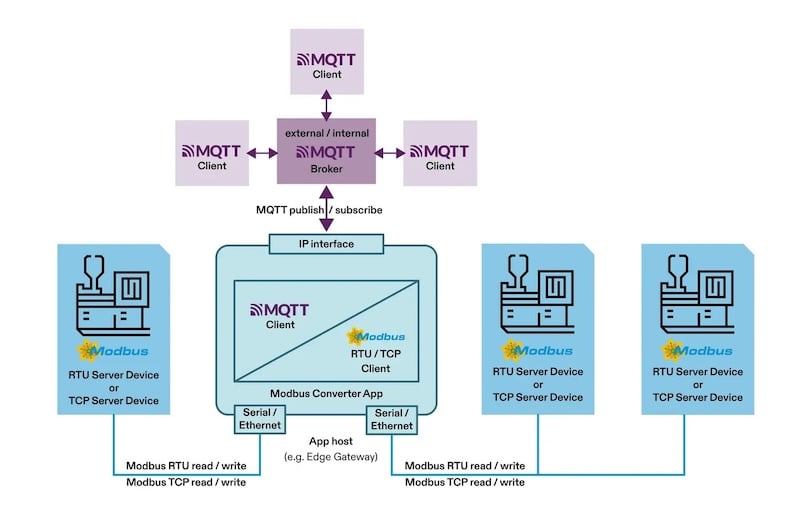

The netFIELD app acts as a platform-independent software container. As such, it allows for the quick conversion of Modbus data into Message Queuing Telemetry Transport (MQTT) protocol. The primary advantage of doing so is that many IIoT devices use MQTT, which is lightweight, open, and simple. As many IIoT devices end up on low-bandwidth, high-latency, electrically noisy networks, MQTT is a good choice for relaying data.
The netFIELD app makes adapting between Modbus and MQTT easy and simple.
The netFIELD app makes adapting between Modbus and MQTT easy and simple. Image courtesy of Hilscher

First, the app’s host is connected to the Modbus devices through its wired ports. From there, the app reads and writes data periodically, based on the configuration files. Data exchange is sent to the user as MQTT messages through the UI, so that they can make data-driven decisions. Adjustments to the process can be made through the UI as well.
The netFIELD app acts as a central piece, integrating Modbus RTU/TCP devices with MQTT.
The netFIELD app acts as a central piece, integrating Modbus RTU/TCP devices with MQTT. Image courtesy of Hilscher
