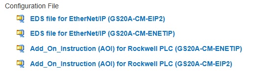

In the more modern case, the VFD is networked to a PLC. This process requires a couple more steps.
 Figure 4. This drive includes downloads for the EDS and AOI files for a Rockwell PLC.
You must find and download an EDS, or electronic data sheet, for an Ethernet device. We already have a tutorial for installing those files. PROFINET and EtherCAT have similar data sheets. Once the data sheet is installed, a new VFD with a unique name and network address can be added to the project.
To more efficiently use the devices, some manufacturers will provide add-on instructions (AOIs), which are simple function blocks that address start, stop, speed, acceleration, directions, and other common instructions. The instruction is associated with the name of the drive when it was added to the project.
