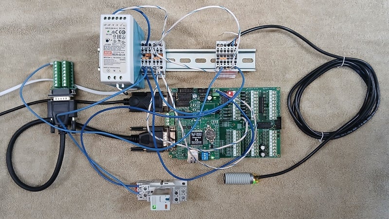

Finished project with extension cable for analog I/O
Figure 1. Finished project with extension cable for analog I/O.

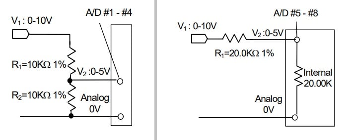

Converting 10 V to 5 V
Once we have picked an input group to use, we need to settle on a strategy for connecting our sensor. This sensor provides a 0-10 V output, but the inputs are designed for 0-5 V. On the surface, this may seem inconvenient, but it actually allows greater flexibility because it’s much easier to knock 10 V down to 5 V than it is to double the voltage with an amplifier circuit.
If we choose inputs 1-4, we will create a voltage divider using a pair of 10 kΩ resistors. If we use inputs 5-8, we will need to place the sensor output in series with a resistor equal in size to the 20 kΩ of the input. Conveniently, we can use 2x 10 kΩ resistors in either scenario.
Resistor combinations for inputs 1-4 (left) and inputs 5-8 (right)
Figure 2. Resistor combinations for inputs 1-4 (left) and inputs 5-8 (right). Image used courtesy of TRi PLC

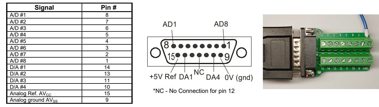

For this experiment, I purchased an extension cable and a breakout board for the DB-15 connector that contains the analog I/O. The analog ground 0 V signal on pin 9 is internally connected to the power supply 0 V, so we only need to supply the 0-5 V signal to the pin. I’m using analog input 1, on pin 8, and an ultrasonic distance sensor.
 Analog signal pins. Pin 8 (A/D 1) is used for this project
Figure 3. Analog signal pins. Pin 8 (A/D 1) is used for this project.
