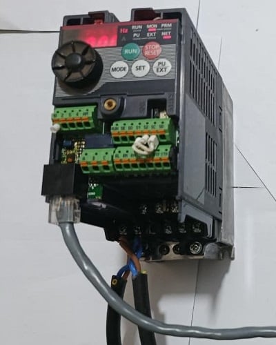

Choosing a VFD speed control method always comes down to practical factors such as desired complexity, operator access, and network availability. In this article, we’ll compare the various control methods using the example of a Mitsubishi FR-D700 VFD.
 Figure 1. The Mitsubishi FR-D700 inverter.
Figure 1. The Mitsubishi FR-D700 inverter. Image used courtesy of the author

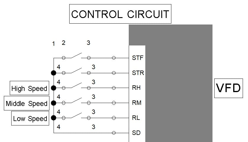

Multi-Speed Selection
Most drives build upon this fixed speed concept by supporting multiple preset frequencies that can be stored and triggered with digital inputs. When a simple switch connects the STF and SD terminals along with the RH terminal, the motor runs at the preset high-speed frequency. Instead of just one fixed speed, the drive can switch between several preset speeds depending on which input terminal is activated. For parameter settings, the high-speed preset uses Pr.4, middle speed uses Pr.5, and low speed uses Pr.6.
 Figure 2. Basic control circuit example for a multi-speed setup: RH is a high-speed input, RM is a middle-speed input, and RL is a low-speed input.
Figure 2. Basic control circuit example for a multi-speed setup: RH is a high-speed input, RM is a middle-speed input, and RL is a low-speed input. Image used courtesy of the author
Besides being easy to set up, fixed and multi-speed VFD control methods offer consistent, predictable operation. This removes the need for extra analog hardware or a communication network.
An obvious drawback is the limited number of selectable speeds, and you cannot adjust the speed gradually or continuously, which makes this method less flexible.

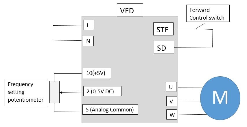

External Analog Control Using a Potentiometer
A very common way to control motor speed is by connecting a potentiometer directly to the drive’s analog input. This is a simple and practical way to adjust speed without a PLC or network. The drives reads the incoming signal voltage, usually 0-10 V or sometimes 0-5 V, as a frequency command. Turning the potentiometer changes the voltage, and the drive adjusts the motor speed accordingly.
The potentiometer works as a voltage divider, sending a variable signal to the drive. The drive reads this voltage in real time and adjusts its output frequency, allowing smooth speed control. When the voltage is zero, the VFD runs at minimum frequency (usually 0 Hz), and at 10 V, the VFD runs at maximum frequency. This method offers smooth, continuous speed adjustment and is simple and low-cost. However, the control precision is limited by the knob’s rotation angle, and the signal can be affected by electrical noise and interference.
 Figure 3. Sketch of the FR-D700 potentiometer connection for frequency adjustment.
Figure 3. Sketch of the FR-D700 potentiometer connection for frequency adjustment. Image used courtesy of the author
