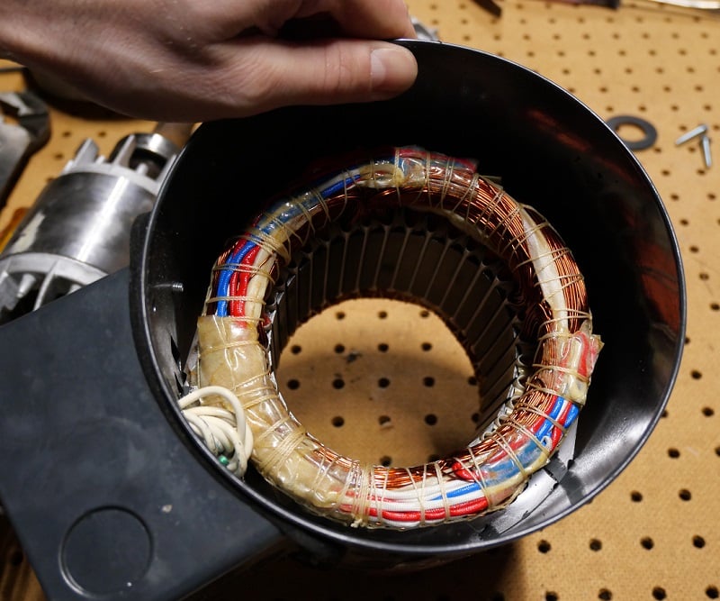

The Winding Coils in the Stator
Finally, the last important piece of the motor is the set of windings wrapped around the rotor but never contacting it. Since this part of the motor is stationary, it is called the ‘stator’, to complement the rotor.
Motor Stator and Windings
Figure 8. The winding coils.
The 3 phases of electricity are not placed in three groups around the outside edge, as might be often shown in simple animated graphics of motor theory. If there were only 3 large windings, the force would be applied only to one edge of the rotor at a time—not very good for balanced rotation.
Instead, the three phases are split and distributed around the perimeter, providing a nice, smooth balance of force.
Distribution of Winding Coils
Figure 9. Close-up of the stator, with the windings passing through isolated slots.
This motor has 36 individual winding distributions. This means that each phase will be energized equally 12x times around the perimeter, as distributed by the 6 individual coils, and wired for high or low voltage by the electrician.
