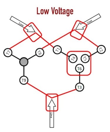

You are troubleshooting a faulty motor. This is a typical 9-wire 3-phase motor configured for 480 volts.
Resistance measurement from T1-T2 measures 8 Ohms.
Resistance measurement from T2-T3 measures 6 Ohms.
Resistance measurement from T1-T3 measures 6 Ohms.
What is the fault in this motor?
The fault is a shorted coil, either T9-center or T6-T3.

You are troubleshooting a faulty motor. This is a typical 9-wire 3-phase motor configured for 208/230 volts.
Resistance measurement from T1-T2 measures 2 Ohms.
Resistance measurement from T2-T3 measures 4 Ohms.
Resistance measurement from T1-T3 measures 4 Ohms.
The fault is an open coil, either T9-center or T6-T3.
Resistance measurement from T1-T2 measures 1.66 Ohms.
Resistance measurement from T2-T3 measures 2 Ohms.
Resistance measurement from T1-T3 measures 1.66 Ohms.
The fault is a shorted coil, either T7-center or T4-T1.
