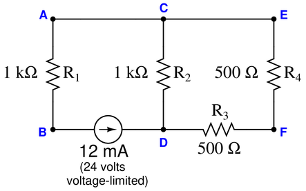

Suppose a voltmeter registers 0 volts between test points C and F, but measures 24 volts between those same test points when the connection between B and C is broken:
Identify the likelihood of each specified fault for this circuit. Consider each fault one at a time (i.e. no coincidental faults), determining whether or not each fault could independently account for all measurements and symptoms in this circuit.
$$\begin{array} {|l|l|} \hline Fault & Possible & Impossible \\ \hline R_1~Failed~open & & \\ \hline R_2~Failed~open & & \\ \hline Q_1~Failed~open & & \\ \hline R_1~Failed~shorted & & \\ \hline R_2~Failed~shorted & & \\ \hline Q_1~Failed~shorted & & \\ \hline Voltage~source~dead & & \\ \hline \end{array}$$
$$\begin{array} {|l|l|} \hline Fault & Possible & Impossible \\ \hline R_1~Failed~open & & \surd \\ \hline R_2~Failed~open & & \surd \\ \hline Q_1~Failed~open & & \surd \\ \hline R_1~Failed~shorted & & \surd \\ \hline R_2~Failed~shorted & & \surd \\ \hline Q_1~Failed~shorted & \surd & \\ \hline Voltage~source~dead & & \surd \\ \hline \end{array}$$

Suppose a voltmeter registers 0 volts between test points {\bf C} and {\bf F} in this series-parallel circuit:
$$\begin{array} {|l|l|} \hline Fault & Possible & Impossible \\ \hline R_1~Failed~open & & \\ \hline R_2~Failed~open & & \\ \hline R_3~Failed~open & & \\ \hline R_1~Failed~shorted & & \\ \hline R_2~Failed~shorted & & \\ \hline R_3~Failed~shorted & & \\ \hline Voltage~source~dead & & \\ \hline \end{array}$$
$$\begin{array} {|l|l|} \hline Fault & Possible & Impossible \\ \hline R_1~Failed~open & & \surd \\ \hline R_2~Failed~open & & \surd \\ \hline R_3~Failed~open & \surd & \\ \hline R_1~Failed~shorted & \surd & \\ \hline R_2~Failed~shorted & \surd & \\ \hline R_3~Failed~shorted & & \surd \\ \hline Voltage~source~dead & \surd & \\ \hline \end{array}$$

Suppose a voltmeter registers 0 volts between test points {\bf C} and {\bf E} in this series-parallel circuit:
$$\begin{array} {|l|l|} \hline Fault & Possible & Impossible \\ \hline R_1~Failed~open & & \\ \hline R_2~Failed~open & & \\ \hline R_3~Failed~open & & \\ \hline R_1~Failed~shorted & & \\ \hline R_2~Failed~shorted & & \\ \hline R_3~Failed~shorted & & \\ \hline Current~source~dead & & \\ \hline \end{array}$$
0 volts between C and E means either no current through that resistor, or it’s shorted and cannot drop a voltage.
