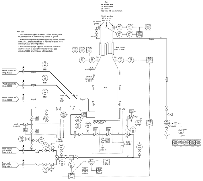

A burner management system (BMS) monitors the status of the flame at the base of this incinerator, to ensure fuel gas does not keep entering the combustion chamber unless there is an established fire to burn it:
Explain the purpose of solenoid valve SV-115, identifying whether it is normally energized (NE) or normally de-energized (NDE).
Also, explain the purposes of SV-111, SV-112, and SV-113 in this incinerator control system.
Solenoid SV-115 vents all actuating air pressure from flow control valve FV-38 whenever its coil is de-energized. Thus, SV-115 is “normally energized” to maintain actuating air pressure to FV-38.
Solenoids SV-111, SV-112, and SV-113 act to prevent fuel gas from reaching the incinerator’s burner assembly when the Burner Management System (BMS) sends a trip signal. SV-111 and SV-112 are block valves, while SV-113 is a bleed (“vent”) valve, making this a “double-block and bleed” valve arrangement. A similar solenoid valve arrangement can be seen on the pilot burner gas line with solenoids SV-101, SV-102, and SV-103.

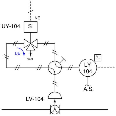

Sketch arrows next to each of the two solenoid valves showing the directions of air flow in the energized (E) and de-energized (D) states, assuming both of the solenoid valves must “trip” in order to force the process valve to go to its “fail” position (i.e. 2oo2 to trip):

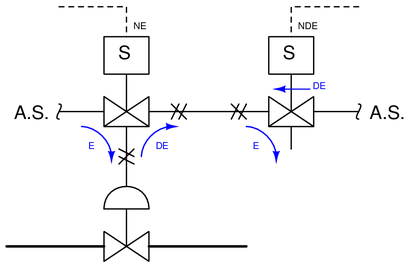

Sketch arrows next to each of the two solenoid valves showing the directions of air flow in the energized (E) and de-energized (D) states, assuming the process control valve is supposed to be open in regular operation and close if both of the solenoid valves “trip” (i.e. 2oo2 to trip):
