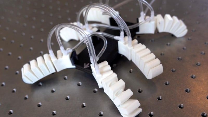

The Purdue University research team has applied the logic of bistability to a soft robot gripper and robot legs. Without the packaging, the popper deforms slightly, meaning a line of poppers will change shape. If stacked all in one state, the grip will turn inwards, providing a gripping surface. If they are popped and unpopped in sequence, this could advance a robotic leg a little at a time.
Off-the-shelf fidget poppers may have been the inspiration, but the team at Purdue 3D prints its own custom poppers. These custom poppers provide design flexibility and allow the researchers to run channels and fittings for the pneumatic actuation system used to pop the poppers. While using compressed air to actuate the poppers may not be as satisfying to the bored student, it allows researchers to program which pieces are popped at any given time.
Walking robot made with pneumatically-actuated fidget popper legs
Walking robot made with pneumatically-actuated fidget popper legs. Image used courtesy of Purdue University Mechanical Engineering
