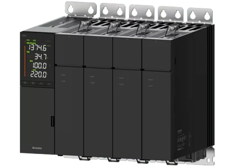

The new SPRS Series modular power controller.
The new SPRS Series modular power controller. Image used courtesy of Autonics
Modular Architecture Improves Flexibility
The SPRS series uses a modular design, so the control and power sections can be installed separately. This lets users replace just one power module instead of the whole controller, which helps lower maintenance costs and reduce downtime. Its compact size means you can mount several units close together, making it a good fit for panels with limited space. Autonics offers four power module sizes with current ratings from 25 A to 600 A so that users can handle both small heating jobs and large industrial processes.
