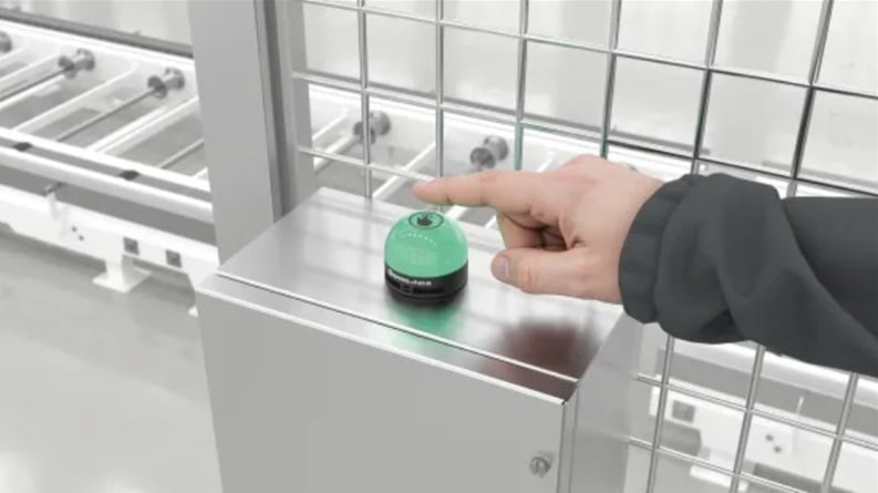

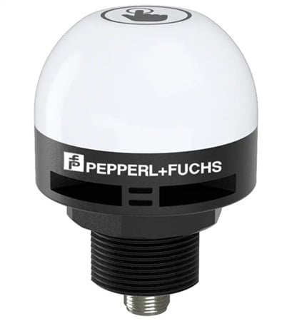

 Figure 1. The new compact IO-Link signal light cap with capacitive touch function.
The new compact IO-Link signal light cap with capacitive touch function. Image used courtesy of Pepperl+Fuchs

One key feature of the new ICA-SB-MCST signaling device is its small size. At only 55 mm in diameter, the signal light cap fits well in places with limited space. It works well for robotics end effectors, assembly stations, and modular production equipment where saving space is critical.
Even though it is small, the device offers an optional touch feature for quick and clear machine status updates. Its multicolor LED can illuminate in over a million colors for custom selection, or in one of eight pre-set color options. Users can set up lighting patterns and behaviors using the IO-Link interface, helping machine builders keep visual signals consistent across different production lines.
Besides visual signals, the new signal light cap has a built-in multi-tone alarm with 10 tone options and an 85 dB sound level. The mix of customizable lights and sounds helps operators tell different machine events, production states, and maintenance needs apart using custom profiles. While its sound is not as loud as Pepperl+Fuchs’ larger IO-Link signal tower, which reaches 105 dB, it is still suitable for many machine-level uses where local alerts are enough.

 Figure 2. The signal light cap can be used in signaling operations in the automotive industry.
The signal light cap can be used in signaling operations in the automotive industry. Image used courtesy of Pepperl+Fuchs

Pepperl+Fuchs’ signal light cap is designed for many uses, namely those where local signals and operator input share high importance. In automotive skid positioning, it can show the position status and let operators confirm completed tasks right from the device using the touch feature. For robotics end effectors or packaging machines, local signals help technicians quickly check machine conditions without needing to look at a central HMI.
