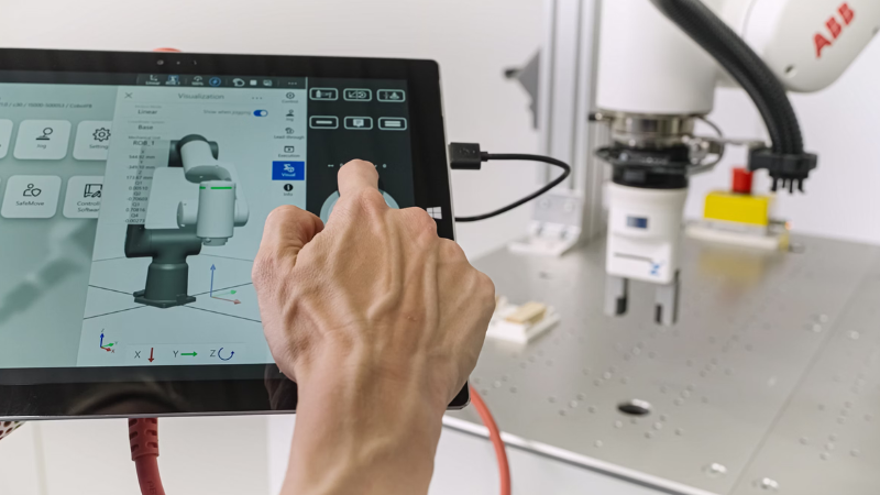

Designed for OmniCore robots, e-Device provides the physical interface that enables users to program, operate, and monitor robots from their own devices. With e-Device, customers can access ABB RobotStudio and other software tools, including AppStudio, a no-code tool for creating customized application screens.

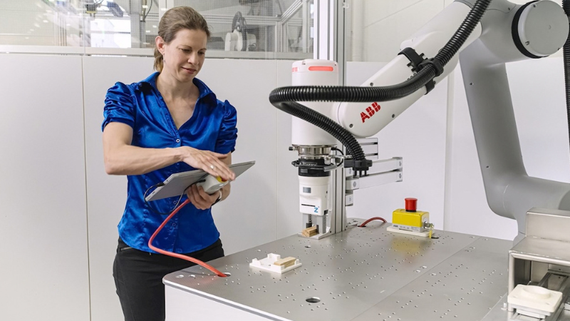

E-Device itself is not just a software UI; it is a physical device that connects to laptops and tablets. The connection includes a hardwired emergency-stop button that can be activated to safely pause operation. This button ties directly into the robot's emergency logic; it is not an add-on. It meets ISO 10218:2025 safety standards and is both CE and UL certified.
By running the OmniCore UI through e-Device, users get a consistent, intuitive control environment on their own devices
By running the OmniCore UI through e-Device, users get a consistent, intuitive control environment on their own devices. Image courtesy of ABB
