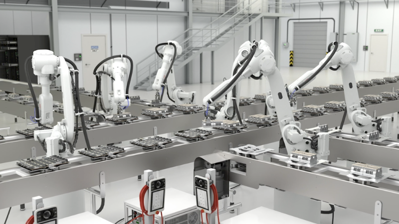

The IRB 1700 and IRB 1700ID target arc welding, sanding, deburring, material handling, machine tending, and AI server rack assembly
The IRB 1700 and IRB 1700ID target arc welding, sanding, deburring, material handling, machine tending, and AI server rack assembly. Image courtesy of ABB Robotics
