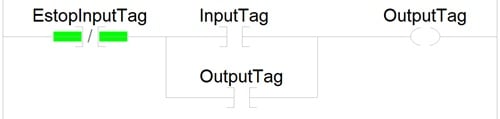

Momentary Output Energize (OTE):
OutputTag := NOT EstopInputTag AND (InputTag OR OutputTag);
Note: If the E-stop is a normally closed device (as most are), then use a NO contact instruction in the ladder, or remove the ‘NOT’ term from the ST code.

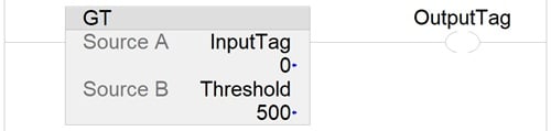

Simple Comparison:
VAR
   Threshold : INT := x; // User input limit value
   Threshold2 : INT := y; // <u>Optional</u> second user input limit value
   Thresholdn : INT := n; // <u>Optional</u> all other user input limit values
END_VAR
IF InputTag > Threshold THEN
   OutputTag := 1;
ELSIF InputTag > Threshold2 THEN // Optional multiple thresholds, like a fill level with intervals
   MoreOutputTags := 1;
ELSE
   OutputTag := 0;
END_IF
All comparison operators are valid:
X Greater than Y X > Y
X Greater than or equal to Y X >= Y
X Less than Y X < Y
X Less than or equal to Y X <= Y
X Equal to Y X = Y
X Not equal to Y X <> Y

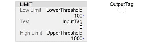

Comparison Limits:
VAR
   LowerThreshold : INT := x; // User input limit value
   UpperThreshold : INT := y; // User input limit value
END_VAR
IF InputTag >= LowerThreshold AND InputTag <= UpperThreshold THEN
   OutputTag := 1;
ELSE
   OutputTag := 0;
END_IF

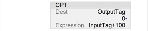

Computation:
OutputTag := InputTag + 100;

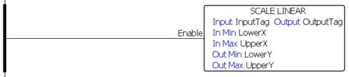

Linear Scale:
As an example to help this make sense, assume you want to convert an input -10 to 10 V signal into its equivalent 4-20 mA signal. This uses the point-slope calculation of a linear equation.
$$ y = m(x-x_1)+y_1 $$
Where
$$ m = \frac{y_2-y_1}{x_2-x_1} $$
VAR
   LowerX : INT := A; // User provided lower input value (ex. -10)
   UpperX : INT := B; // User provided upper input value (ex. 10)
   LowerY : INT := C; // User provided lower output value (ex. 4)
   UpperY : INT := D; // User provided upper output value (ex. 20)
END_VAR
OutputTag := ((UpperY - LowerY)/(UpperX - LowerX))*(InputTag - LowerX) + LowerY;

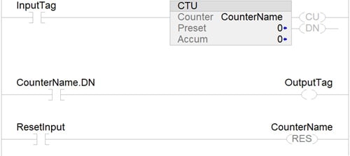

Counter (Up Count):
VAR
   CounterName : CTU;
   PRE : DINT := x; // User supplied preset value
END_VAR
CounterName(CU := InputTag, RESET := ResetInput , PV := PRE);
OutputTag := CounterName.Q;
VAR
   ACC : DINT := 0;
   OldInput : BOOL := InputTag;
END_VAR
// Begins with a rising edge one-shot trigger
   IF (NOT OldInput AND InputTag) THEN
   ACC := ACC + 1;
END_IF;
OldInput := InputTag;
// OutputTag acts as IEC 61131 Q bit
IF ACC >= PRE THEN
   OutputTag := 1;
ELSE
   OutputTag := 0;
END_IF
IF ResetInput THEN
   ACC := 0;
END_IF

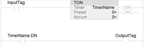

On-delay Timer (TON):
VAR
TimerName : TON;
   PRE : TIME := x; // User supplied preset value, written with #ms, #s, #m, or #h suffix
END_VAR
TimerName(IN := InputTag, PT := PRE);
OutputTag := TimerName.Q;

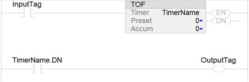

Off-delay Timer (TOF):
VAR
   TimerName : TOF;
END_VAR
