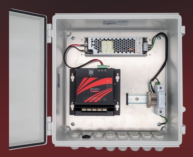

The ruggedized housing, integrated surge protection, and power supply of the LANOBOX enclosures provide an all-in-one solution.
The ruggedized housing, integrated surge protection, and power supply of the LANOBOX enclosures provide an all-in-one solution. Image used courtesy of Antaira

The enclosures include an unmanaged PoE switch with an optional pole mount kit for LANOBOX-PMK available for purchase separately. Wall mounting is also possible.
The LANOBOX-105-T features a power supply capacity of up to 200W and a total PoE Power Budget of 120W at 48~56VDC power input.
The LANOBOX-105-T features a power supply capacity of up to 200 W and a total PoE Power Budget of 120W at 48~56 VDC power input. Image used courtesy of Antaira
Specifically, the LANOBOX-105-T accommodates 5*10/100/1000Tx RJ45 ports with 4*IEEE 802.3at (PoE+) outputs, providing up to 30 W per port and a 120 W total power budget. With these features and capacities, the LANOBOX-105-T can support network edge devices such as access points, cameras, and sensors. Other additional accessories include the LSP-0200X-bt-100-T and LSP-0400X-bt-100-T surge protectors.

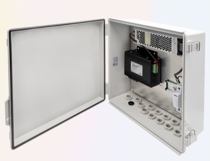

Comparatively, the LANOBOX-212-T accommodates 4*10/100/1000Base-T IEEE 802.3bt ports providing up to 90 W per port (Type 4), 4*10/100/1000Base-T IEEE 802.3af/at ports providing up to 30 W per port, and 4*100/1000 SFP slots for fiber uplinks. The total PoE power budget is 240 W at 48~55 VDC power input, and the enclosure supports a power supply of up to 350 W. SFP slots enable connection to high-speed fiber optics without degrading the signal or introducing unwanted interference.
Installers can count on standard wiring to install and save time, and the surge protection prevents issues from progressing further down the line, which could have detrimental impacts on control room processes. The durable enclosure and integrated power supply offer protection against the elements and eliminate the need for costly external, bulky power supplies.
